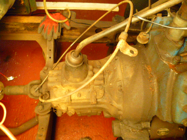

I'm currently looking to replace the flathead v8 and manual (very short ) gearbox from a 47 pickup . There is limited length due to a chassis crossmember that cradles the end of the box . This cannot be modified so have to fit the new engine and box forward.

I'm guessing here, but I would think the 4 speed manual box from a Rover P6 would be the shortest.
Then you are getting on to the LT77 and later boxes which are longer because they are 5 speed.
I used an R380 + very short bellhousing from Ashcroft Transmission (which is meant for a 4 cylinder engine), then a 4-8 cylinder adaptor plate.
You can get a 2wheel drive R380.
That was the shortest I could come up with (that would take 300BHP though!).
Looks like this:
