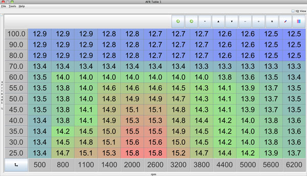

im tweaking my Afr table on megasquirt 2 and wondered would anyone post theirs up for comparison.
mine is below and is basically the afr table generated in megasquirt, how do you think it looks for a 3.9 in a Tvr Chimaera?
Afr table
Re: Afr table
Very much like mine in my 3.5 EFI. I ended up with 14.1:1 at idle, which got it to the 1.5% CO which is the spec for my car.
