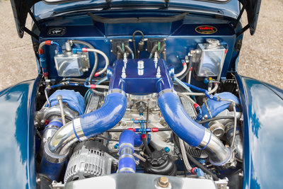

Hi all I’m thinking of using a water to oil, oil cooler due to
Not having anywhere to mount a conventional cooler , the literature with the water to oil coolers want to know the flow rate in litres per minute,so I can work out what model to buy , so my question is what is the oil pump flow rate in LPM of a serpentine engine ???
Thanks Nick
Thanks Nick

Thanks for the replys this is a link to to the oil cooler I'm thinking of using your will see the question being asked about the size hence my question I assume yes asking the question regarding maximum flow but if you guys would mind having a look and give me your opinion

Hi tom doing a twin turbo 3.9 in a tr7 , and assumed that I would need an oil cooler ??I've heard twin turbos in a tr7 can get very hot so wanted to start with the best cooling system I can , I've got a big ally rad with a shrouded spal fan , I'm going to fit big winged sump and thought a oil cooler wouldn't hurt either , the reason behind the water to oil cooler was space, I've got 2 big intetcoolers covering 98% of the rad and these not much space in front of the intetcoolers, and the opening at the front of a tr7 is small ,having the intetcoolers in front of the rad is not going to help cooling much and wack a oil cooler infront of them it's going to be worse hence my thoughts on water to oil coolers , I know there will be trade off the water to oil coolers in that it will increase the temperature of the coolant but if I block my intetcoolers with a oil cooler it will hurt boot temp and hurt coolent temperature prob more than the extra bit heat the water to oil cooler will put back into the coolent hope this makes sense
Nick

Hi there I’m. afraid I don’t have water cooled turbos ,
I can’t fit a conventional air to oil cooler as it will block the whole intercooler and the intercooler blocks the rad , I’ve got a couple of other places I could fit air to oil cooler but it won’t see much air , I’m thinking it fitting a big wing sump that should help a bit , maybe I should just
Try it without the oil cooler and see how hot it gets ????
