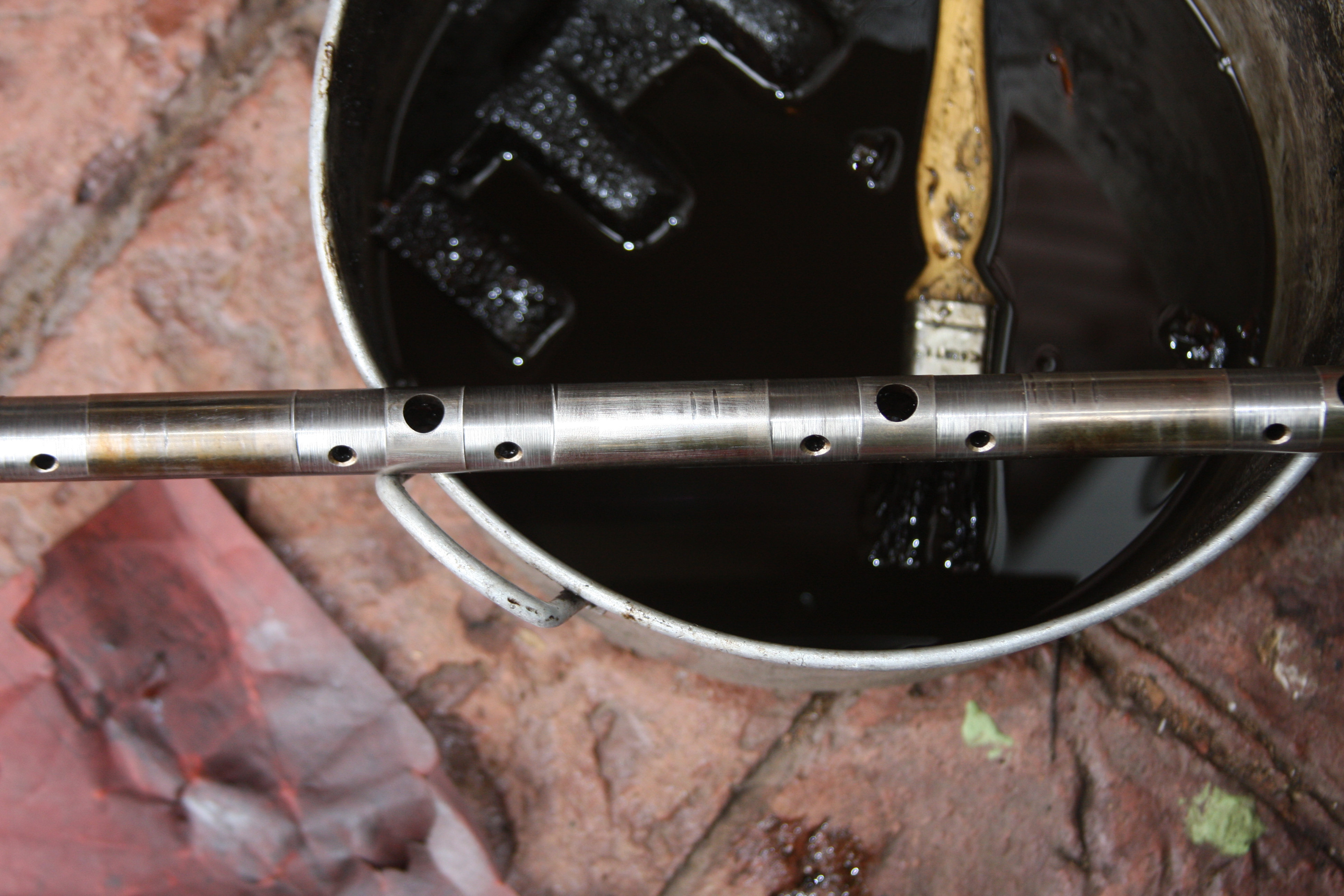

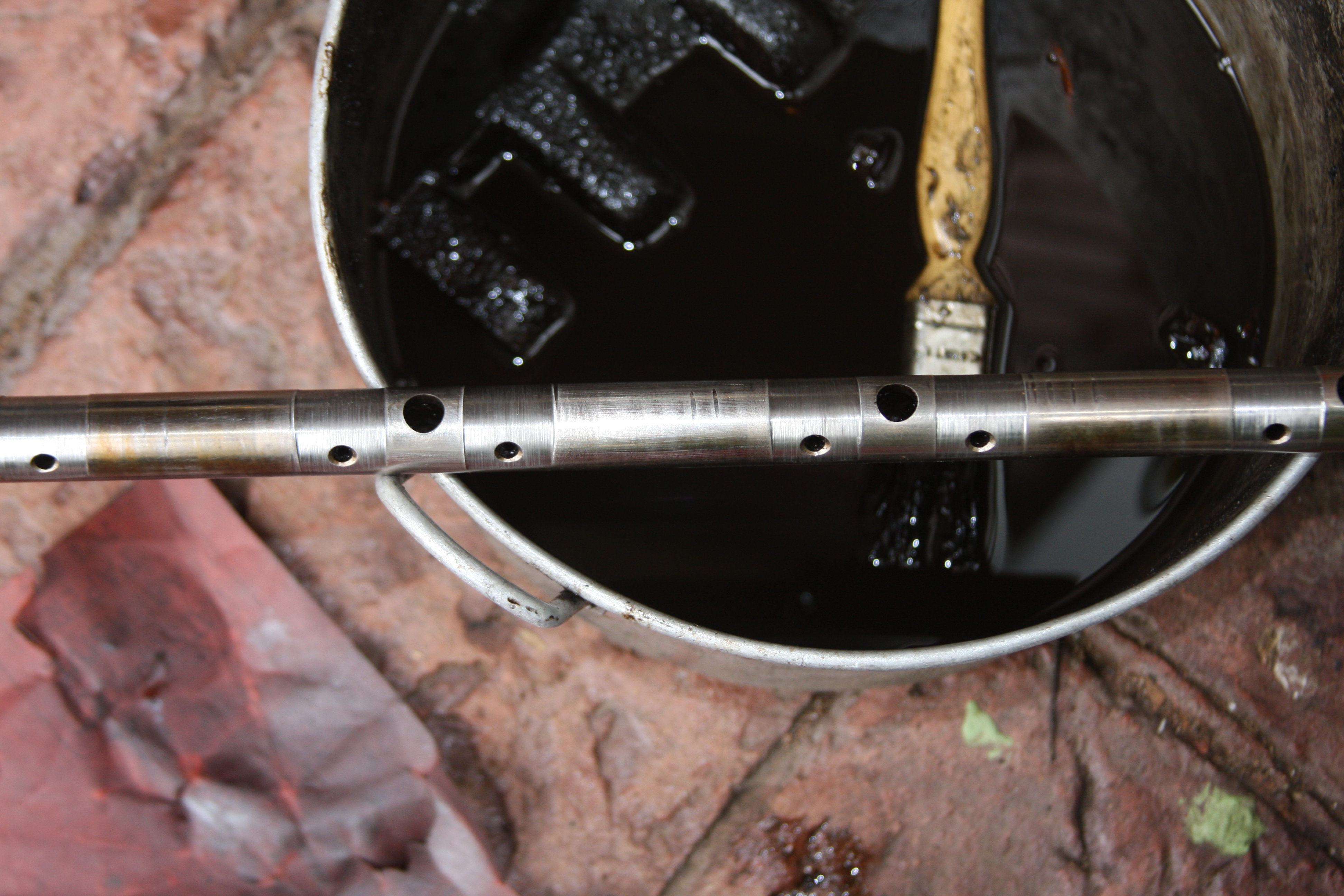

Re: How do I stop tappet noise?
I bought a well worn 3.5 as a rebuilder . I found that while there was a lot of rocker/rocker shaft clearance by far most of the wear was on the underside of the shaft where the rocker bears against it( I believe that crap in the oil embeds itself into the surface of the relativly soft ally and then abrades the steel shaft ). The rockers look ok but must be biffed in the bin. As a diagnostic fiddle I rotated the shafts 1/2 a turn and the noise went away. It's possible that the preload on each lifter being different, the excess clearance on the shaft may be accommodated by some of the lifters with more preload ...not all. The inserting of a feeler gauge mentioned by one poster may well be taking up rocker /shaft clearance . ............buggered cam will never help
Hamish
Hamish
Late to the party as usual, but...my engine also 74,9.25:1 CR. Some tappet noise. Probably 315k kms. Underside of rocker shafts badly worn, so I replaced with aftermarket shafts and rockers, couple of oil changes. Now nice and quiet. Genuine rockers are crazy $$$, and I am never going to wear these cheap parts out.
