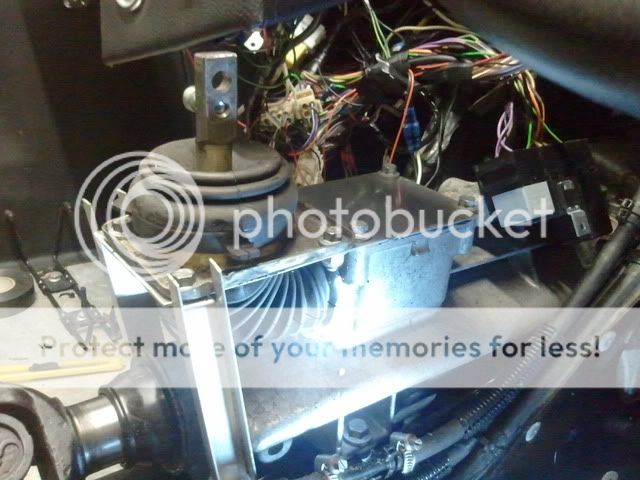

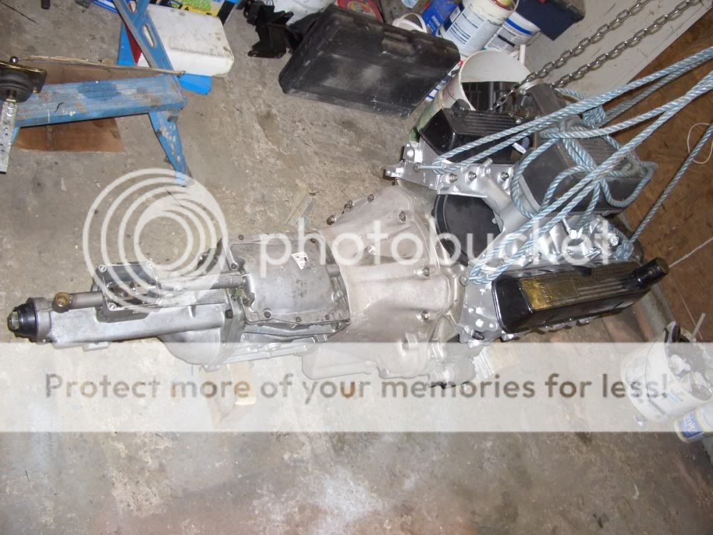

Hope these help, they are some photos i took along the way
You need this bit on the Cossie T5:
This is where the mounting plate is:
A shot of the other side of the tunnel:
Position of gear lever and highlighted mounting plate:
Huge bell housing!!!:
This is the AP slave i ended up with, the SAAB one supplied was 'supposed' to seal against the bell housing but never did. I had to have the mounting surface machined in order to get it centered and the correct distance from the clutch:
Gear lever position:

hi mike,
wow those pictures are what I was after, many thanks.
Helps me understand the problem better now.
Not too worried about the gear level position now, as looks very similar to mine now, only really gearbox mounts to work out.
Will do some more measuring at the weekend....when I have time.
thanks again for your help.
regards
scott

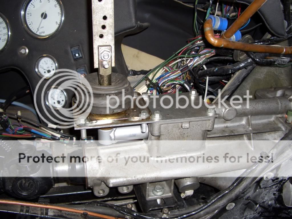

I put a T5 WC and bell housing from my TVR Griffiths 500 donor. I had to make up a remote gear level as WC was too far forward. Otherwise it was easy but mine is a Dax Rush. Plenty of installed pictures if you ever need them.
Cossie (top) vs WC.
Cossie (top) vs WC.
Richard.
