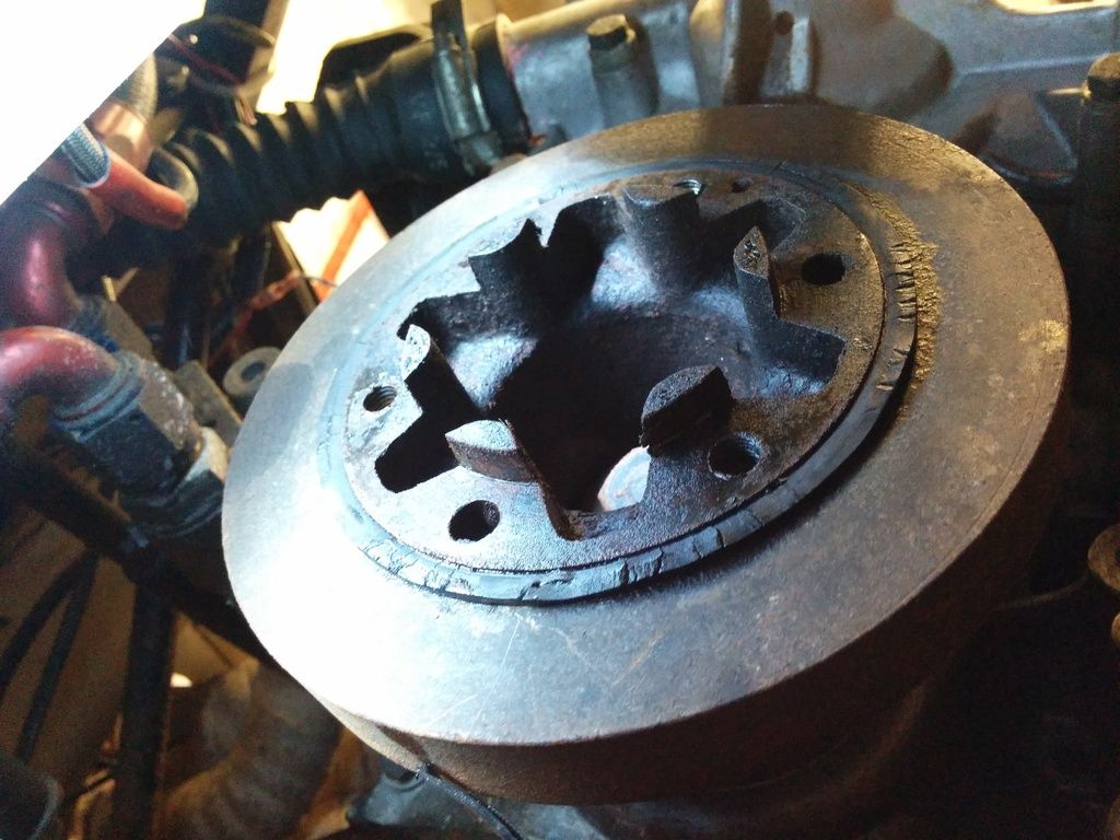

Edit: This is my Damper:
See how the metal part where the holes are is proud of the rest of the damper - so you can't "squash" the rubber part no matter how you try. That's what I meant by the "lip".
Looking at it, I am assuming the mass of the "outer" part of the damper acts as the damper - even though it's not connected to anything directly, it acts as a damping flywheel of sorts? Or is the outer part thie bit that is connected to the shaft, and the inner bit is connected via the rubber to the outer part? That would make more sense.

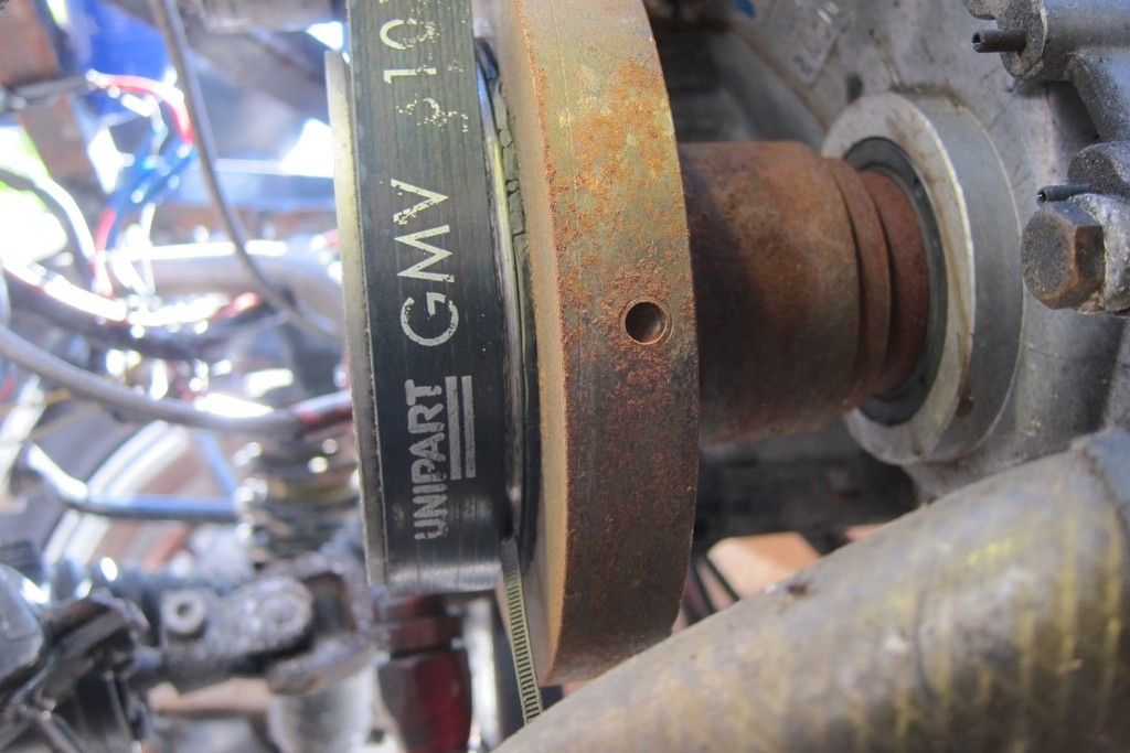

Before:
After:

How does your trigger wheel attach to the back of the pulley? Is there a gap between it and the metal ring/mass damper?
The iron ring (I think they're iron) of the mass damper should only be coupled/bonded to the pulley hub by the rubber section.
You're rubber does look rather cracked, are you sure there is no play between it and the hub as that could cause noise?
Also noticed from your photo that the shaft looks rather rusty, hopefully the rust doesn't continue under the seal because that will never seal and leak.
The outer ring of the pulley assembly is mounted on rubber and MUST be free to flex and not touch any other bolt on item such as the front belt pulley or the trigger wheel. Usually there is a 5mm thick spacer ring between the trigger wheel and the centre boss of the assembly. The rubber section of your pulley assembly is badly perished and it may have got too hard to do an effective damping job. Have you checked that the outer ring is not loose on the rubber and does the ring run true when viewed with the engine running?RogerD wrote:Hi. I'll remove it and take a look today. The vibes started the moment I messed with the damper ... I.e bolted on the timing gear.
The rust stops immediately as it enters the engine .
