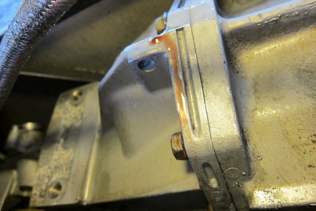

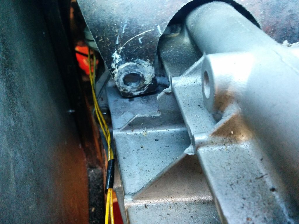

1) It's running duration dependent, not temperature. I warmed her up and she leaked.. I worked on the floor pan (removing the ally that covers the trans tunnel for a good hour. Started her up and she leaked immediately - with cool oil. Car on stands, in neutral. Later tried again (with floor trans tunnel cover removed and I could see the leaking straight away (as per linked video). When running in neutral I assume the spinning gears are whipping the oil around and finding the leak point.

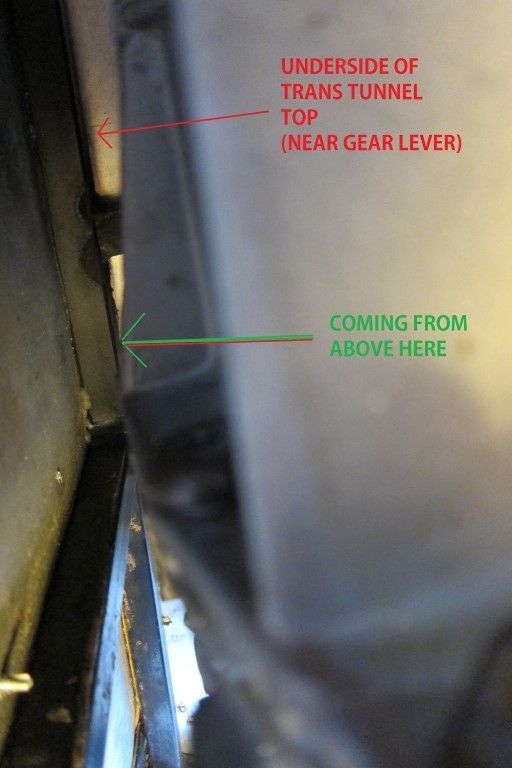

2) The leak is coming from some area that seems to be near the gear selector. From under the car it leaks near a join (but not from it) under the gear stick area. When looking up I can see the the oil is not coming from any visible location - it is coming from above where I can see - so presumable the top or upper side of the area in question).

Looking up from underneath:
