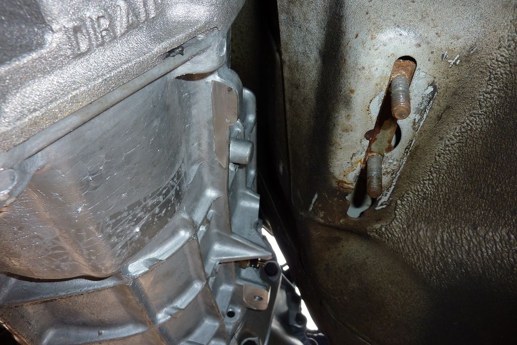

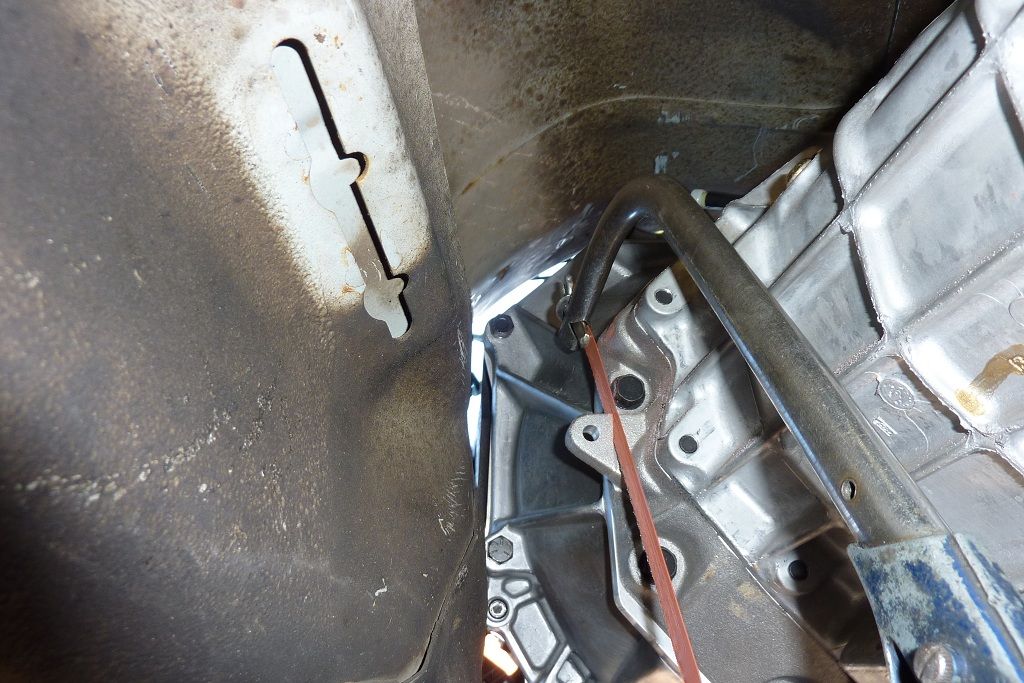

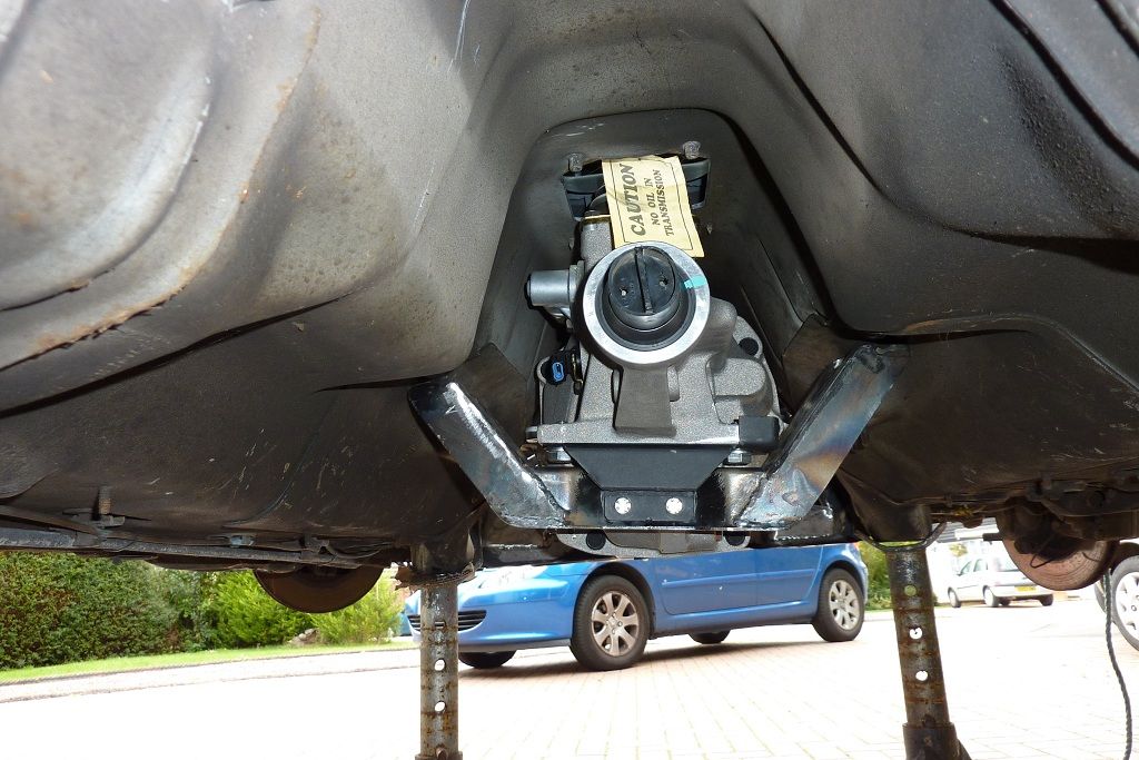

T56 went in fairly easily.
The main problem was around the home brew bell housing, I had to give the transmission tunnel a good beating with a club hammer to get it to clear - no cutting required though.
Other than that there is plenty of room in the stock tunnel, mine is a Mk2 and I think the tunnels are bigger compared to Mk1.

Not sure how a Sierra tunnel compares to a MK2 Granada
But the T56 fitted into mine fairly easily too. I just removed the original gearbox mount that went up and over the tunnel. Like a second skin about 3-4" wide that created the mount.
Then welded up some new mounts
Although I had already done this for the R154 Supra box anyway. So a little trimming of some lugs off the T56 and it was an easy swap.
It is a big box, and it is a tight fit. But certainly not a difficult one.
