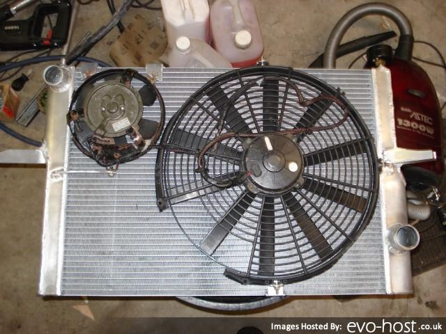

What are the dimensions of your water rad ? And which fans, and what rad coverage do they give ?
I just put a new rad on mine, as old was leaking plus I made some changes
It's same dims as old anyway, just some fitment alterations.
700mm end tank to end tank, 435mm tall and 45-50mm thick ( Core is 45mm I think, header tanks are a bit more )
Single large 16" Spal puller and a second hand motorbike fan on the corner.
