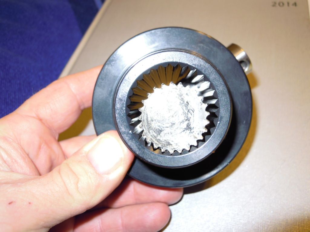

The shafts were made from stock size Ford 9" blank stock and machined to have MGB hub setup on one end and then turned down to fit the MGB diff gears on the drive ends.
I have now figured out that I can slightly alter my diff cage so the thick section of the shaft will fit through the bearing carriers and into the diff cage.

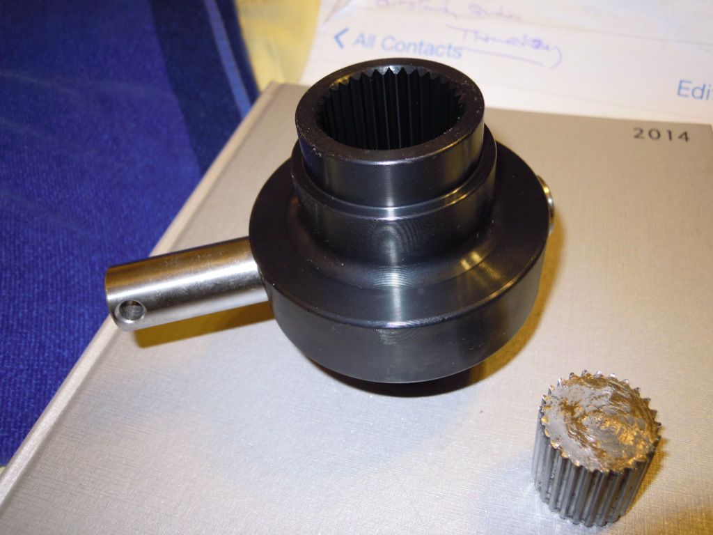

I have also found a Ford 9" mini spool jobby that can be machined down to fit inside the diff when the four small cogs are removed. This only fixes into postion with a diff pin, so I intend to make some girdle plates to weld onto the spool and onto the diff cage itself. You can see in the picture how much fatter the new shafts will be with Ford 31 spline ends.
The Mini Spool that Mike found for me looks like this

With such a large shaft and small splines, they are always going to take a bashing.
The only Moser shafts that never twisted on me were the 28 spline small diameter shafts
All the 31 splines twisted, but they were also all larger diameter shafts. As did the 28 spline with the larger diameter shaft.
So a bit of flex can go a long way to saving them
But ultimately they need to be stronger anyway. Give Mark Williams a shout
