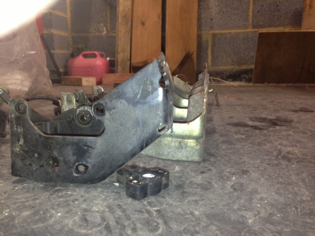

will get a pic later today Eliot,
basiclly it comes out to far and is in the way of the plenum elbow now the plenum has been turned around,
been told TVR etc use a very stumpy setup with mounting bracket etc,

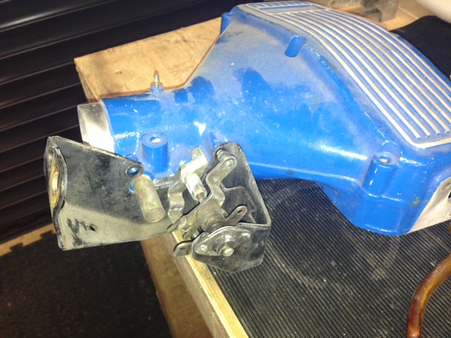

this is what i currently have mate,
you didnt read the post tut tut
the plenum has been turned around so that the plenum intake is now on the drivers side

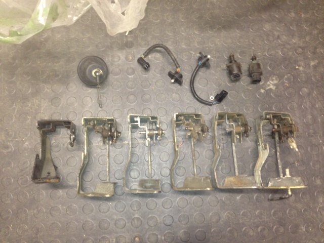

you are in luck, i have one or two brackets...
Although now looking through my manifold archive, i have a feeling its off a Gems plenum...
..But just been back out into the garage and tried it on a hotwire plenum and it fits...
So you can have that one or a std one to cut up or just cut yours up knowing I have a few here that I i'll keep aside for you.
And the wife nags me for collecting so much stuff....

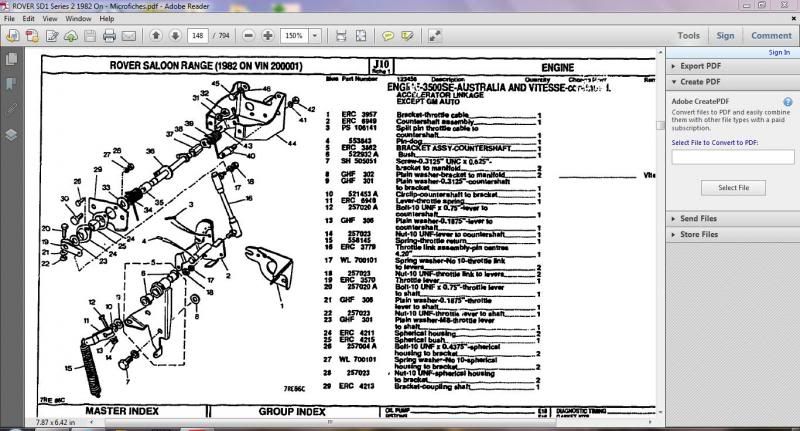

The SD1 has the cable part (throttle and auto) fixed to the back of the cylinder head and a rod linkage from that to the plenum.
So doesn't stick out past the plenum air entry.
