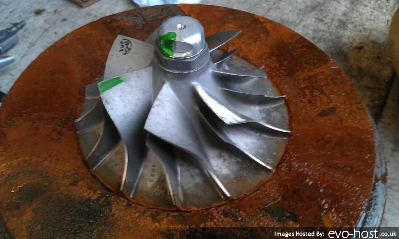

This is the impeller.
Approx 80mm inducer, 121mm exducer and 35mm tall. Didnt undo the centre nut or try and dismantle. There are other units, this is the largest of them though. No idea how it compares to what you are looking at.

Might be some water in there....but it still spins freely. Dont know why it's rusty looking like that though, it's aluminium
As for practicalities of using it for something....I'd say they weigh around 25-30kgs each. They're bloody heavy !
Turbine housings are huge.
Thank you for looking, that looks close but I think the exducer dia is a litle large.
My current (damaged) comp wheel has:
70mm inducer
108mm exducer
44mm height (not including nut)
I can (and want to) go bigger with inducer upto 80mm but I think exducer and height are maximums. Also the bore is 0.5" so would have to be smaller than this.
Do you know the dims of the other comp wheels?
70mm inducer
108mm exducer
