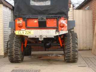

This is the length of a unimog pinion :
Gordon
