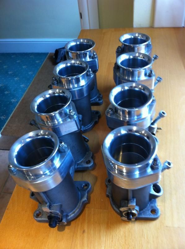

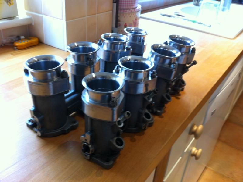

Speak to John Eales, he occasionally has second hand jenveys, I bought mine that way. On my old 4.8 with mild cam, wasted spark (edis8) and megasquirt with 50mm TB's I ran 307bhp. HTH

I will go for approx 45mm Jenvey throttle bodies on 4.8litre.. 50mm is far to big for 4.8litre..
I run my 5.2litre stage 4 engine (+390hp/552Nm) 48mm Jenvey´s.

Getting inlet manifold and bodies from Mr Eales he suggested 48mm

kokkolanpoika wrote:I will go for approx 45mm Jenvey throttle bodies on 4.8litre.. 50mm is far to big for 4.8litre..
I have also got MS3X base map if yuo need it.. :)
I agree, I bought them when I was planning on supercharging the 4.8 so thought they'd flow better. They are currently sat on my 6.3 chevy with Inglese manifold :lol:

I am now wondering if I need the 45mm throttle bodies as the merlin heads have fairly small ports.
