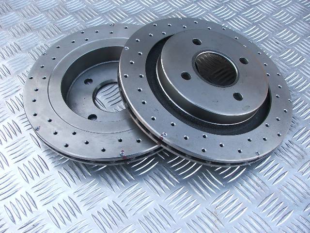

the new rear discs for the mussie axle:
before cross drilling:
after i spent an hour on the pillar drill:

if you look back over the build tom you will see i was already running these discs last year
but new axle decided new discs too,
the discs all finished,
