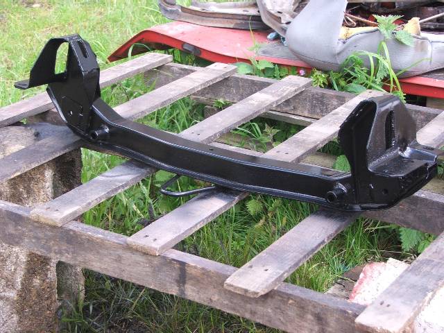

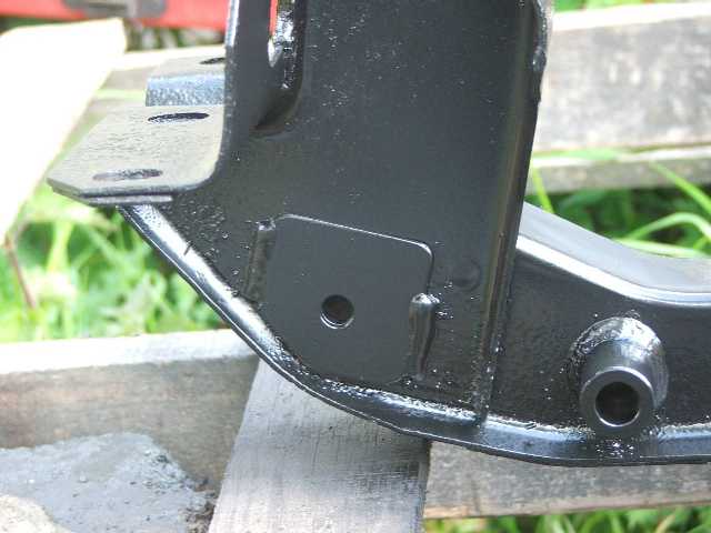

picked up a new crossmember today at caprisport, and made a few mods to it,
my last crossmember the inner track arm bolt holes have elongated, which we think is the problem with the steering judder under braking,
so on the new one i did this on the front and back side of the crossmember.
puts a bit more meat around the bolt hole area allowing the bolt to pull up against something a bit more solid etc....

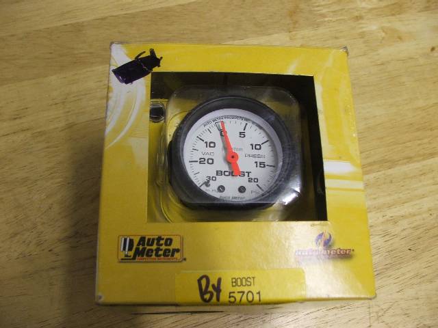

a few more gauges to get then i have the complete set to do the new dash setup for the cappa,
