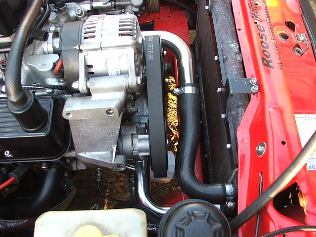

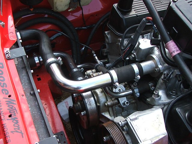

Sorry its late guys but only been home a couple of hrs,
been a long day on the car today,

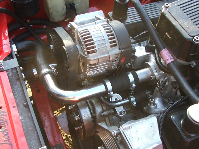

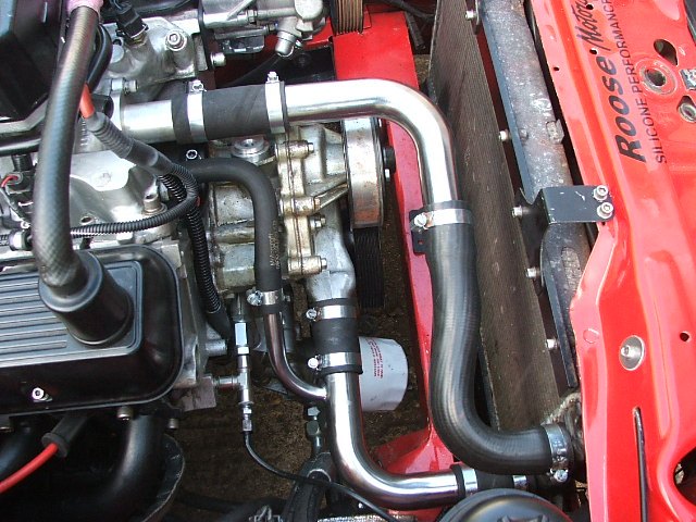

the water system is now sorted,
the bottom and top hose bends have come back from the engineers after having the water bypass pipes tig welded in,
with alternator etc back in place,

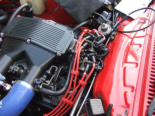

Coilpacks are finally fitted and wired up, YEEEEEEAH

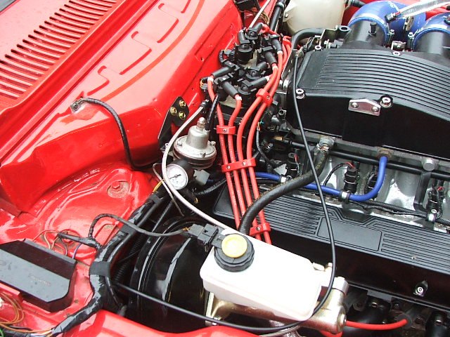

Plenum and fuel reg are fitted and plumbed in,
master cylinder is bolted up to servo now and the start of fitting the braided brake lines to it have started.
fuel line is all fixed inplace now and return hose fitted too.
was handy as there were a few points on the rad header tank bracket where the two fuel lines could be 'P' clipped too :lol:
manifolds are bolted back onto the block too,
at this rate she aint going to be far off being ready for a fire up by Monday night. :twisted:

me too mate,
dnb is doing the msq for me from his 5.0 v8 (similar spec to my 4.6)
he is also going to sort out the same firmware as the msq was done in some im up to date, (not touched the ecu or run the car in a year)

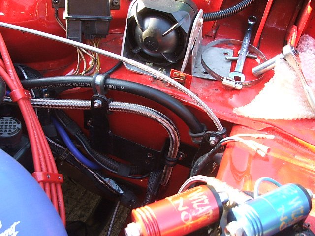

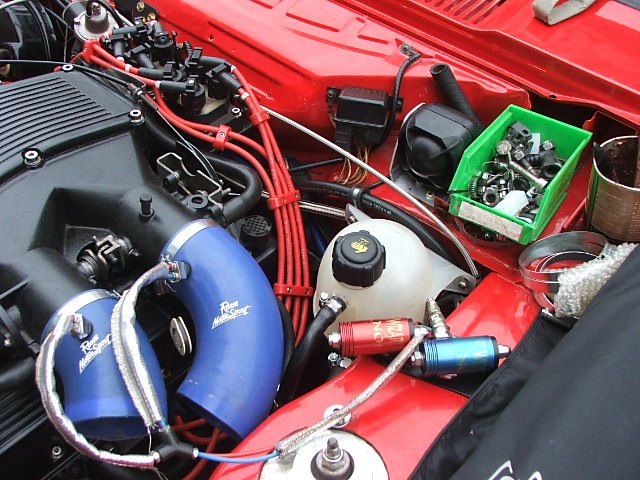

had a funny sort of day, didnt get half the things done i wanted to, but tied up a few loose ends,
servo and master cylinder with hoses on, and fuel reg mounted and plumbed in, and we have a working throttle pedal,
Nitrous fuel pulsoid wired up and plumbed into the main fuel line,
and header tank for radiator fitted and plumbed in,
waterpipes to and from rad,
The complete cooling system is now 100% plumbed in.
the complete fuel system is 100% finished,
the oil system is now 100% finished,
the powersteering pump is plumbed in now back to the PS bottle,
tomorrow (Bank hol monday)
Fitting the new exhaust system,
fitting the new rear shocks,
hoping to be filling her up with oil also, and going to try and turn her over on the key to prime the oil system,
and if im brave i may attempt a fire up :shock:
but need to make sure the ecu settings and firmware are correct first,
