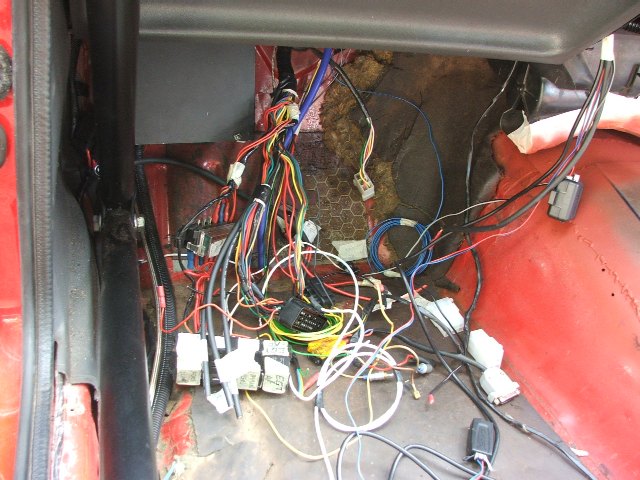

started sorting out the internal wiring too.

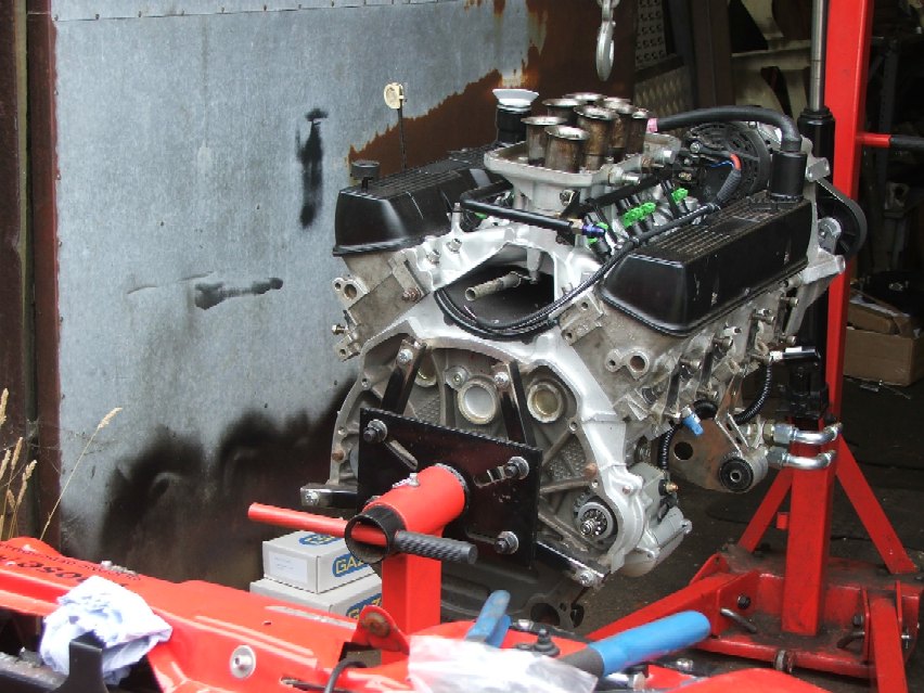

Engine mount fabrication finished, just needs welding now,
Welded and bolted back on dummy block for fitment,

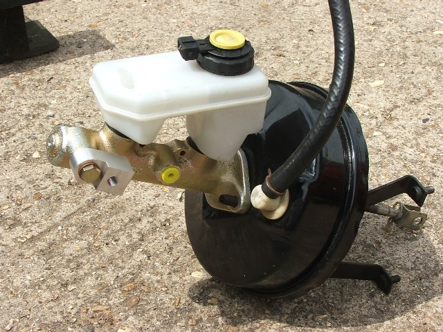

new brake master cylinder set up
uses a land rover 25mm cylinder,

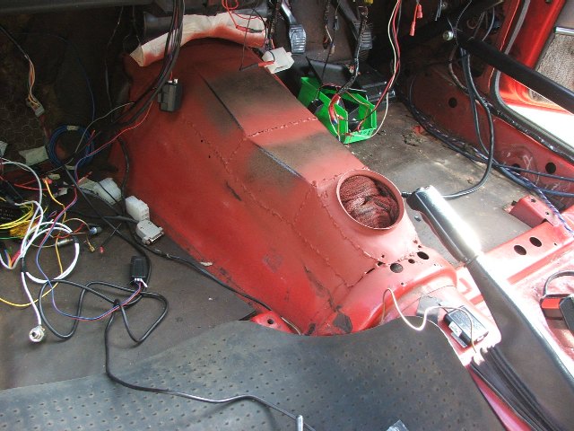

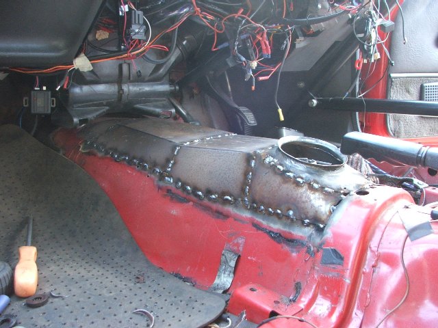

The tunnels now done,
a few bits to finish off then seal and paint,
then need to mod the center console a bit due to the height we have the box at now,
she is coming along now wont be long before we can lower the new engine in to its new home. :wink:

didnt do much on the tunnel today due to the changable weather,
so before the damp set in it got a quick touch up of rust proofer,
never sealed it today as we need to do some welding under the tunnel when the weather allows,

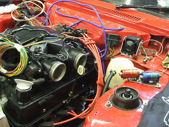

so i made a start on running the new knock sensor wires,
crank sensor wire and coil pack wires,
and tidying the cars looms up where parts have been added and removed etc over the 14yrs of owning her.

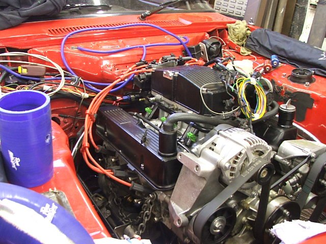

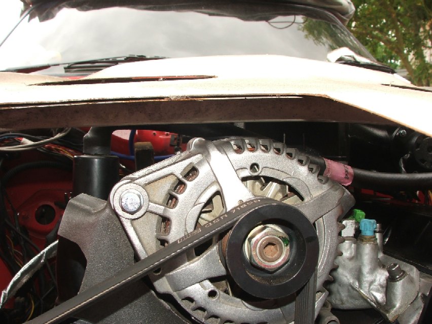

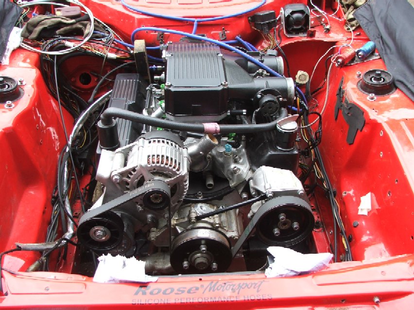

And the dummy engine is coming out next weekend and the new engine going in for a fit up of cooler hoses, coil pack brackets intake pipes etc etc etc,
then will be removed one last time to finish off the engine bay then it will be back in to stay :lol: .

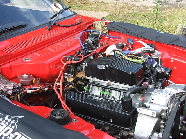

Posts: 6318
well had the day off work as holiday,
and got some more done on the car,
getting ready to go in,
It's in (only tempary)
MMMMMM that was a bit to close for comfort,
thank god the engine is mounted quite solid now :lol: ,

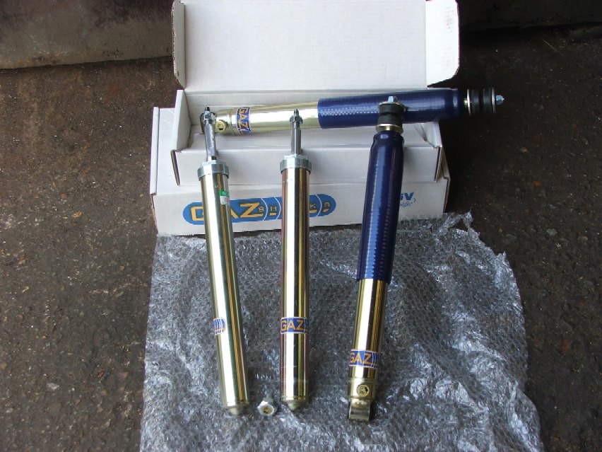

New suspenssion has arrived at last,
so thats another job we can get on with.

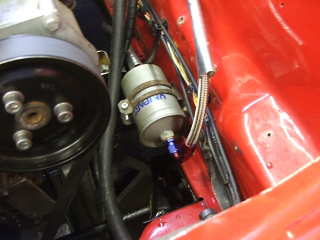

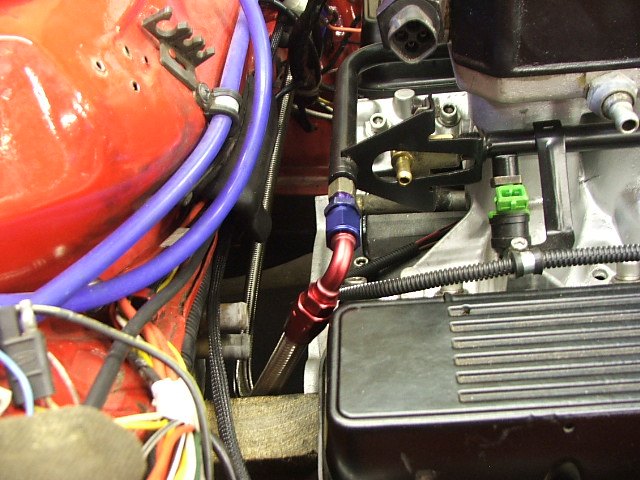

removed the old fuel lines and ran the new -6 braided line and completely plumb the new lines in right up to the fuel rail along with relocating the fuel filter,

finished the tunnel off,

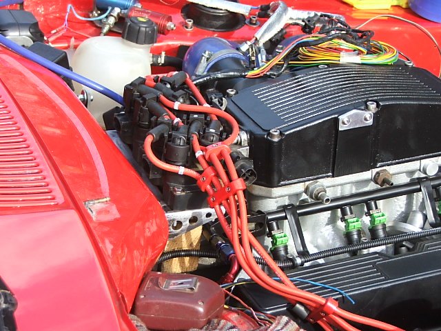

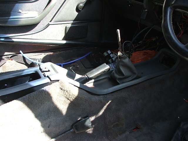

center console sits back as per factory,
a few mods to the framework was needed, but seems fine,
and coil pack bracket was made for the bulkhead,

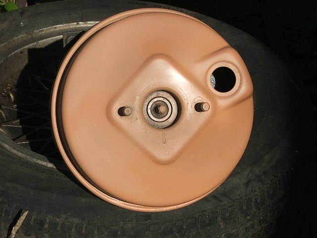

Servo in primer ready for top coat:
