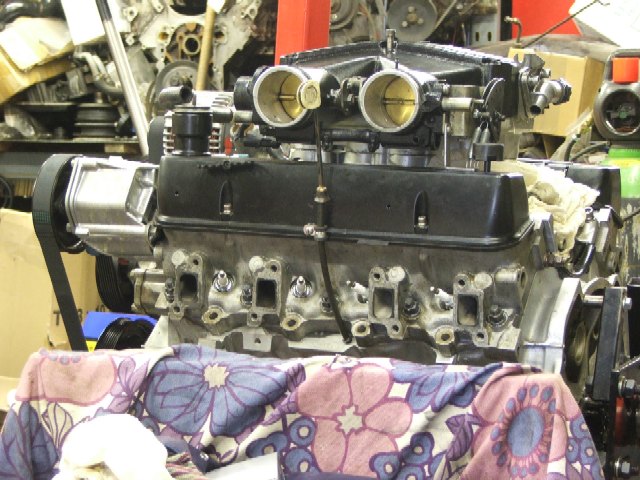

Done some more on the fuel injection side this weekend,
trial fit back on the engine, 90% of the bolts on plenum chamber have now been replaced with stainless allen bolts,.
Hi Rich,
i have used cap head mainly except on the throttle linkage bracket and the 5th injector blanking plate where i have used dome head allen bolts

ta mate, yeah this is the route we are now going to take when i get round to refitting the engine,
hope to get the fuel rail and injectors back in the engine sunday along with sealing the trumpet base to the manifold,
fuel rail and injectors all back in,
