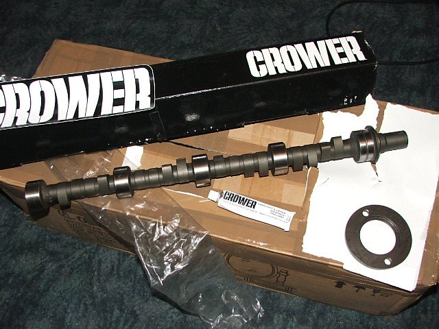

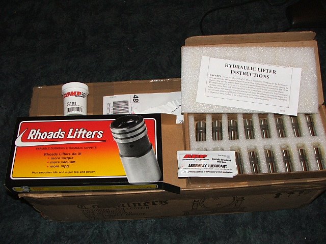

New crower cam, the rhoads lifters and the retaining plate for the cam arrived today,
A speedy turn around from Paul (v8tuner) again.
Lifters:
Cam:
Cam machined for retainer plate:
Cam and plate:

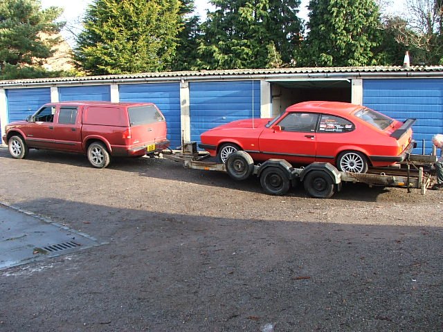

well she left today to go to Caprisport,
first time its seen daylight since August 08 :cry:

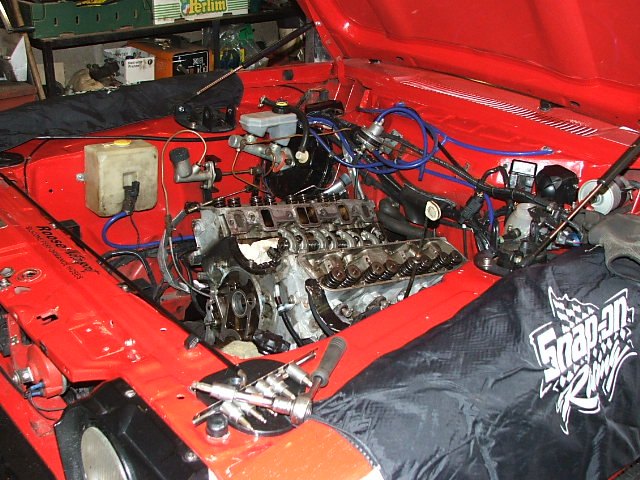

engine getting ready to come out,

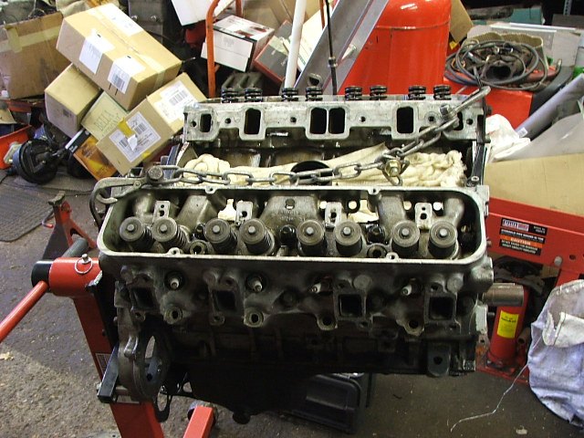

engine out :cry:

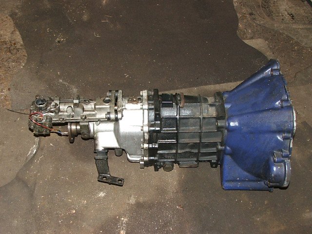

gearbox also removed,
