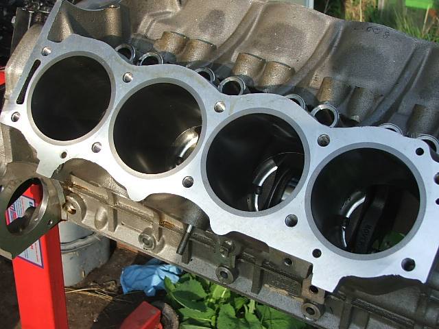

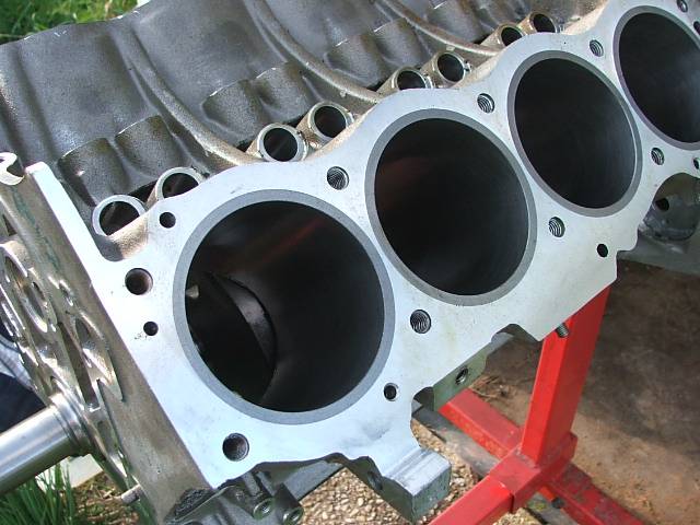

passengers side,
drivers side:
and yup think that means its mine:

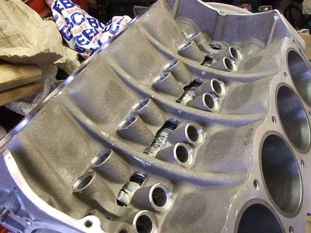

the block needs degreasing, and still has some swarf inside the valley area stuck to the sticky brown shite, but that will be cleaned down this week,

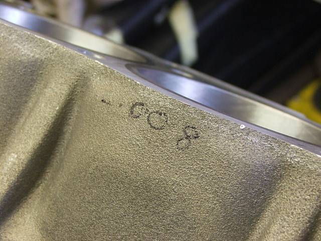

noticed the head locating dowles are missing, so need to contact v8d about them, there is also a mark on the face where it looks like a flat blade screw driver has hit,
that may of been done in transit, otherwise yup im happy,

Cam lubed and sat in block, you can see the mark on the face above cylinder one,
Does anyone know what these numbers may mean???? as wernt there when block went away,

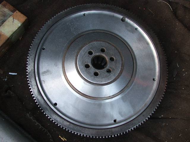

Flywheel now even lighter, not weighed it yet was 11.2kg i think when it went,
UPDATE:
flywheel is now 10.2kg,
so yup its lighter :lol:
ppyvabw
Posts: 824
Location: Newbury
Post by ppyvabw »
Is that a standard cast flywheel?
er yup :lol:

Great to see you have it back, looks like a nice job and see thay have decked the block as you have lost the engine number, did they leave the top hats a bit proud or level with the decks?
Should have a bit more compression anyway, probably .25/1 if they took 10thou. off.
With a pre broken in cam you only have to bed in the rings and your set to go, have fun.
Kevin.
the engine number is still there but very faint,
the liners are flush mate,

friggin' heck mate. I had my current flywheel lightened by about 5 pounds which I thought was ok. It was a Rangie flywheel which I think is a bit heavier than an sd1 flywheel, so I had it taken down to 27lb.
But not to 10!
If that thing holds out I think I might just have a standard one lightened. Let me know if you lose a leg! :lol:

ppyvabw wrote:friggin' heck mate. I had my current flywheel lightened by about 5 pounds which I thought was ok. It was a Rangie flywheel which I think is a bit heavier than an sd1 flywheel, so I had it taken down to 27lb.
But not to 10!
A case of mixing up kg and lbs going on here! :wink:
