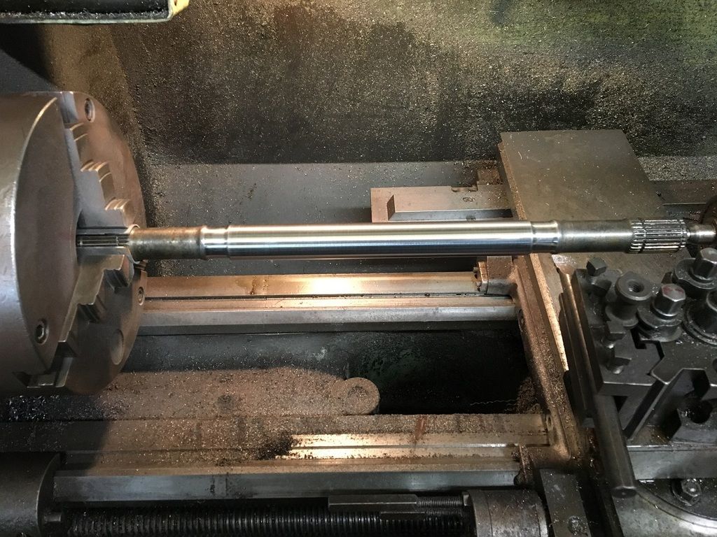

Drive shafts skimmed on the lathe to clean up

Brilliant work ! Oh! I wish I had a machine shop.
So when making spline shafts - you just need HT steel? It doesn't need hardening or anything afterwards?

The jag bits are induction hardened on the splines, but the metal files very easily.
I think / hope it was done just to toughen up the casting !
I quizzed the technical guy at Bohler the supplier of my steel and this grade is used a lot in motorsport as it's pre-toughened with 150,000 psi tensile strength.
Don't want to risk any distortion with further heat treatments and with luck it will be ok !
