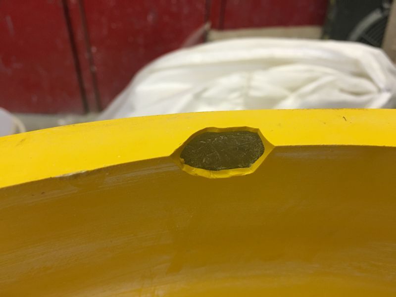

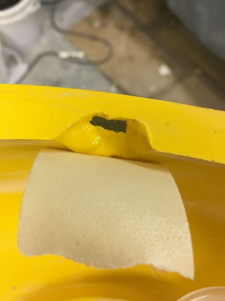

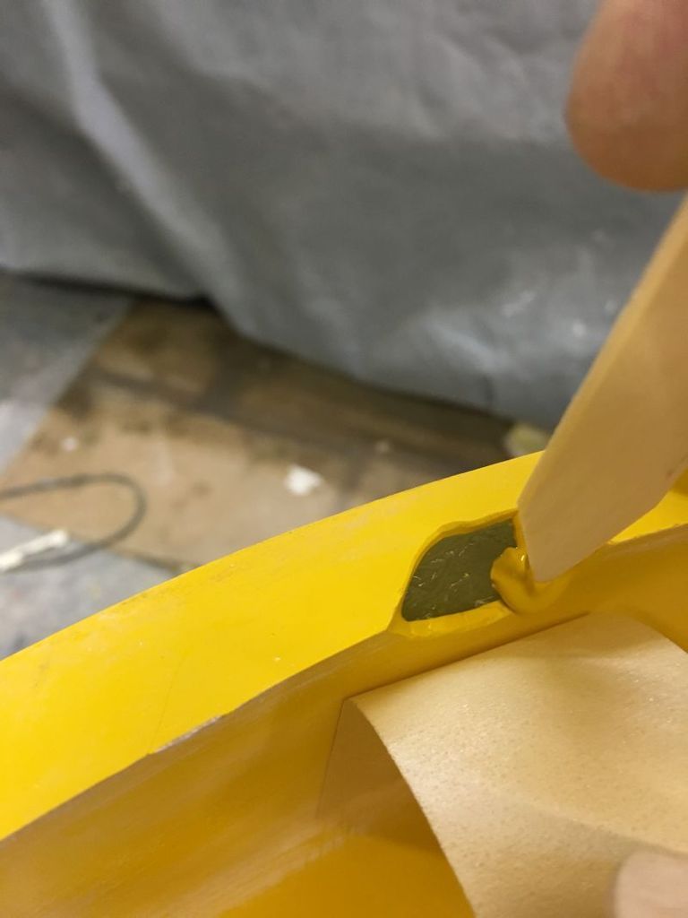

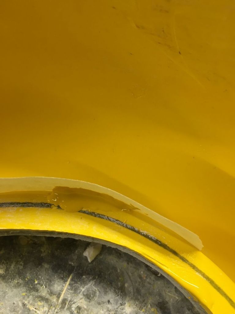

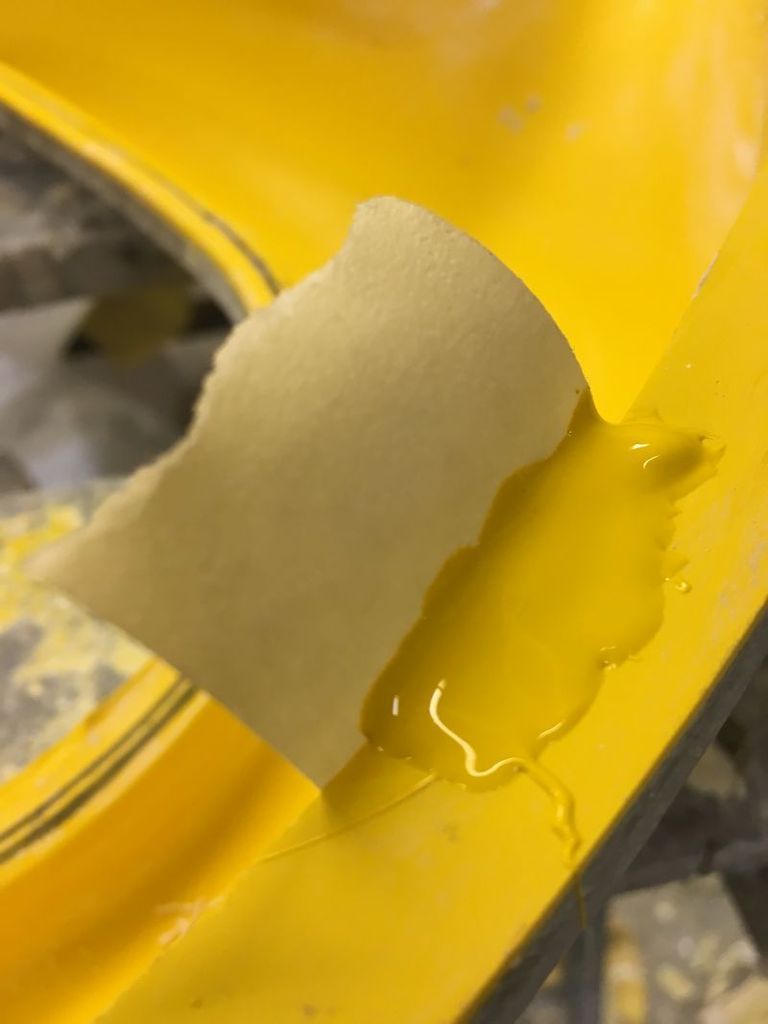

Evening everyone and especially for Andrew .
This is how the small repairs are dealt with.

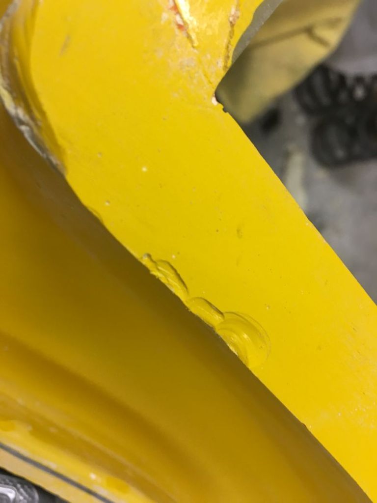

There were a small amount of gel repairs to deal with so satrting with the biggest one first.

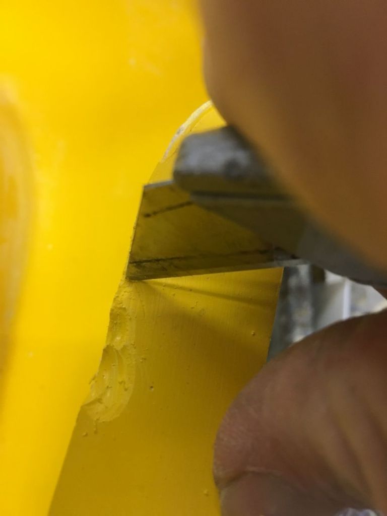

The edges are chamferred back with a stanley knife and then cleaned out with acetone.
It is important to make the edges slightly bevelled as this gives the gel something to grab to as it cures and a sharp edge will never give a proper repair.

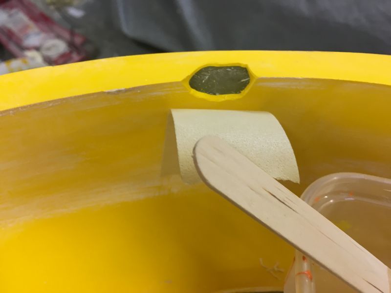

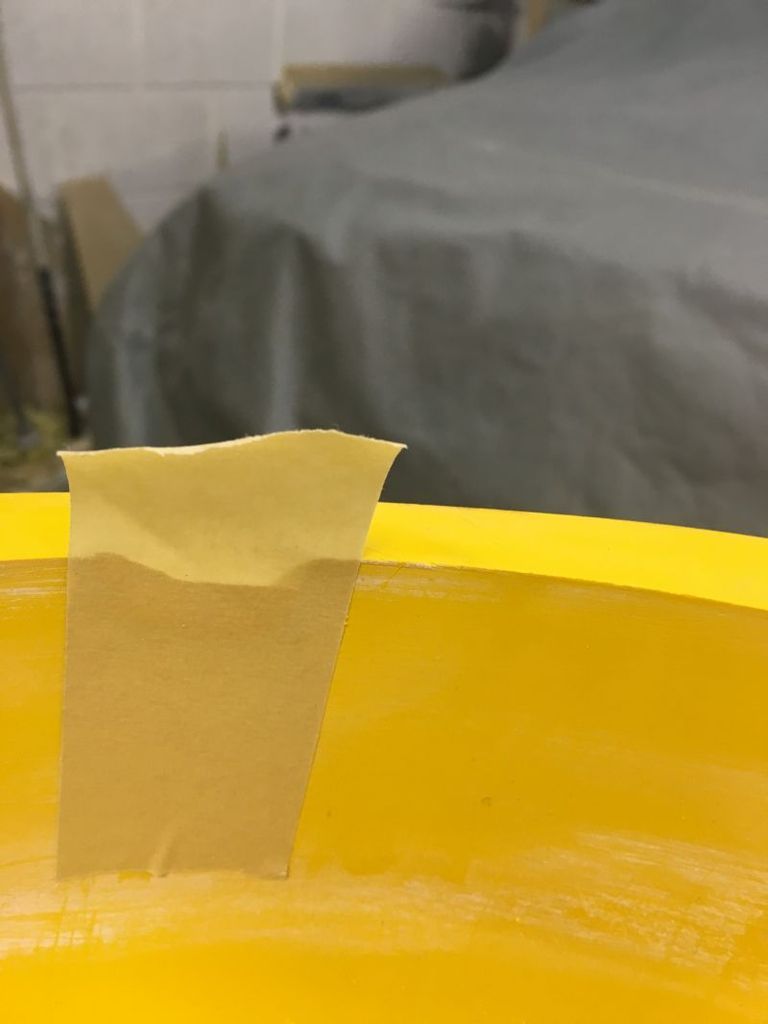

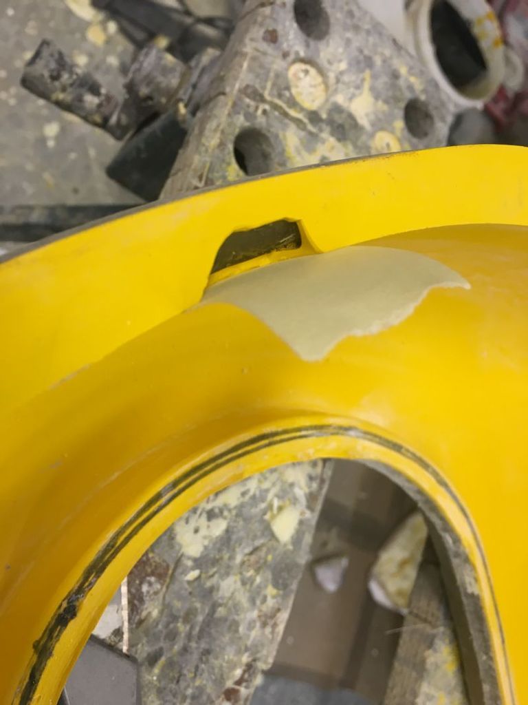

Once this has been done masking tape is placed over the repair site like this.

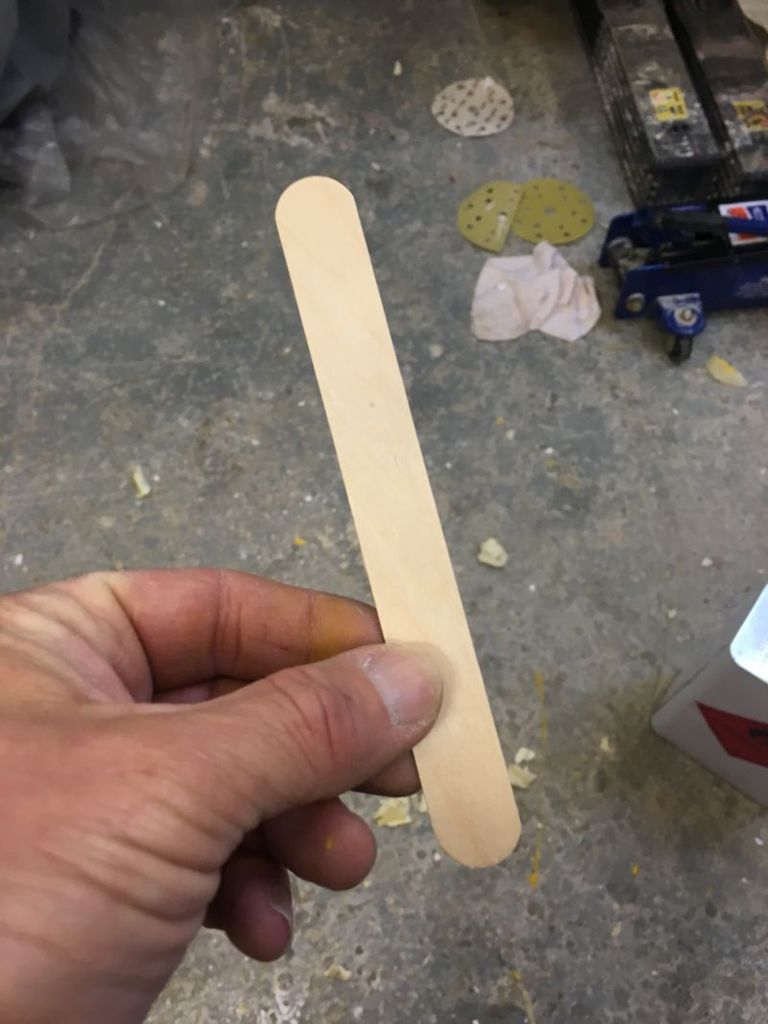

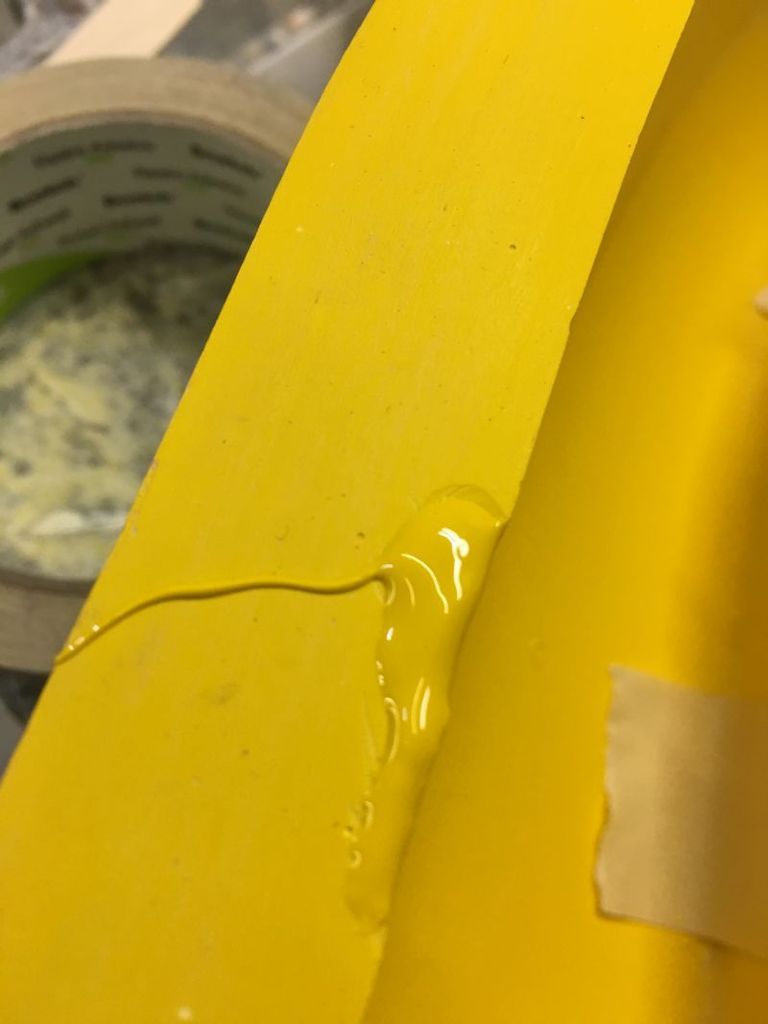

Then it s a case of mixing the gel up and letting the gel in with a wooden tongue depressor.
You can use anything with a point on it to put the gel in as long as its clean.
I peel the tape back and start at the bottom and then draw the tape up to hold the gel in place something like this.
Once the vertical side is done then you can just top the repair up from the top.
The rest of the repairs are done just the same but if very small you can just let the gel in without the tape.
All of this now needs to cure for about 24 hrs so I will probably get back to this on Monday evening.
Hope this helps Andrew?

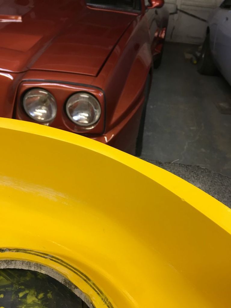

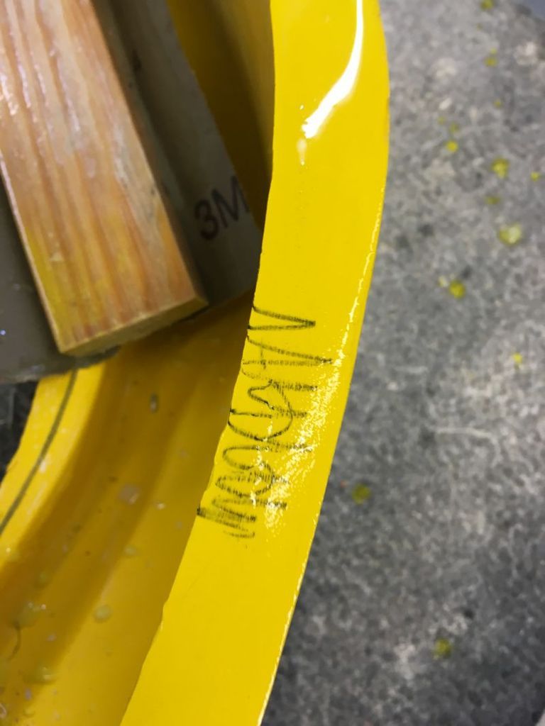

Evenin all
Well I was trying to get this up last night but photobucket was having none of it so hopefully tonight will be better.
Before I put the pics up it would be worth noting that an awful lot of the time people dont think that the gel has gone off because its still sticky and I would not mind a pound for every time it has been mentioned to me thats for sure.
If you have mixed the gel and the catalyst properly and its gone off in the pot then it will have gone of at the repair site.
The reason that it is sticky is because a chemical called styrene has risen to the surface of the gel to provide a chemical key for the next application of gel if there needs to be one.
The sticky makes folk think it has not cured but a quick wipe over the repair site with acetone and the stickiness has gone.

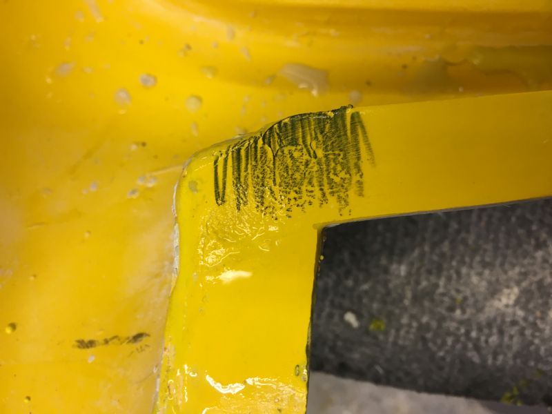

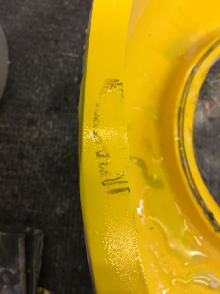

So with that all in mind I have already wiped the small repairs down prior to flatting back.
I generally start rubbing own with 400 after scribbling over the 'fill ' with a chinagraph pencil.
The pencil is my guide coat and it one of the most important tools in our arsenal.
With plenty of water i just sand away trying to give myself a reasonable 'throw' on the block as this keeps the surrounding area of the repair site nice and flat too.
Always try to use a block when flatting back as by just using your finger you will without question get train tracks in the surrounding areas of the repair and you wont get a flat repair either
Once you think you have it fairly flat then chinagraph up again and you will be surprised at how much you have'nt got it flat.
This is greatly exagerated here for you to see and no my eye sight is not that bad thank you and yes I know this is a different repair site to the first one but who cares
If you think you are ready to go down a grade ie onto 1200 then go for that and repeat until there are no black lines at all.
Then one final pass with the chinagrpah and a rub over with 12 and if all is good then you can move onto the next repair.
I am now at the stage where all of the small repairs have been rubbed down in the top section and am going over the whole thing with chinaagraph 400 and then 1200 prior to a good polish up.
As time is limited this week I may or may not get this all finished by Friday.
Any questions?
cheers
P

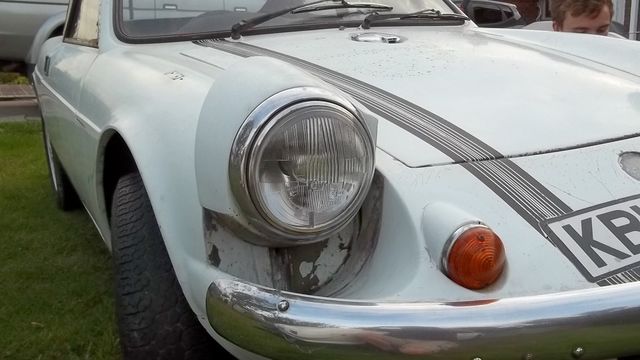

unstable load wrote:Can't you stick the lights in the already there holes adjacent to the radiator opening? It seems like they are there for lights before the designer had a brain fart and made the pop-up lights.
My guess they would be too low to meet SVA or IVA regulations
Nah. Pop-ups were almost a Bertone trade mark in the 70's and I happen to love them. Every "fun" car I have has pop-ups !! even the ones without concealed lights.unstable load wrote: Can't you stick the lights in the already there holes adjacent to the radiator opening? It seems like they are there for lights before the designer had a brain fart and made the pop-up lights.
But design aspects of 60's and 70's classic cars is probably a subject for a different thread.

Topcoat for repairs NO NO NO NO NO AND THEN NOOOOOO.........
Reason is simple
Topcoat sometimes known as flowcoat has a wax added to it so that once cured the surface is not sticky and is and should only be used as a final coating for bare laminates.
Remembering the repairs just recently shown and discussed the stickiness (styrene) is the chemical part of the gel coat that helps in adhesion for second or third applications and also helps to 'bite' into the external edges of a repair site which helps it to stay in place.
Topcoat is exactly the same as gel but has a chemical called a Styrene Monomer added to kill the sticky bit.
Whilst you could do a repair with it it WILL FAIL and in short order too and should only be used as a last resort .
Did I mention that you should not do repairs with topcoat
With regard to the flash lines I would be having a good look at the thickness of the gel prior to any sanding back as sometimes it is very thin and you wont have much to work with once sanding has started.
Also depending on the colour of the gel it may be that you will have to go down as fine as 2000 grit before polishing as the darker the gel the more the sanding marks will show when polished.
If a light colour is being used then you could most probably finish on 1200 and then give it a really good machine polish.
I will talk to you a little closer to the time about compounds and polishing because as always there are good and bad products (in my opinion) along with the right and wrong way to polish (again in my opinion)
With regard to advice on the restyle later in the year I will be more than happy to help you and anyone else with hands on help if required or just a chat down the phone if that is all that is needed.
Never a problem for anyone on here.
cheers
