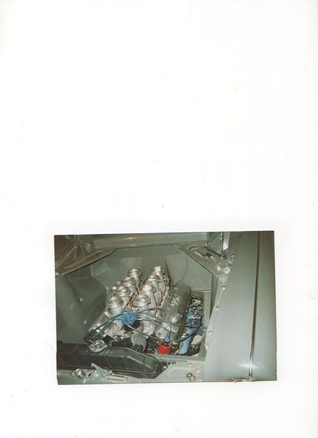

Wow,50mm, thats huge, im running 42s on a 3.9,
Heres a pic of a pair of JE manifolds, slightly modified so they are canted over at 10degs to straighten the run to the heads,
and another pic of my old Zodiac with TJ injected 289,
and a Link to a set that was on EBay last week,
http://cgi.ebay.co.uk/ws/eBayISAPI.dll? ... K:MEWAX:IT
