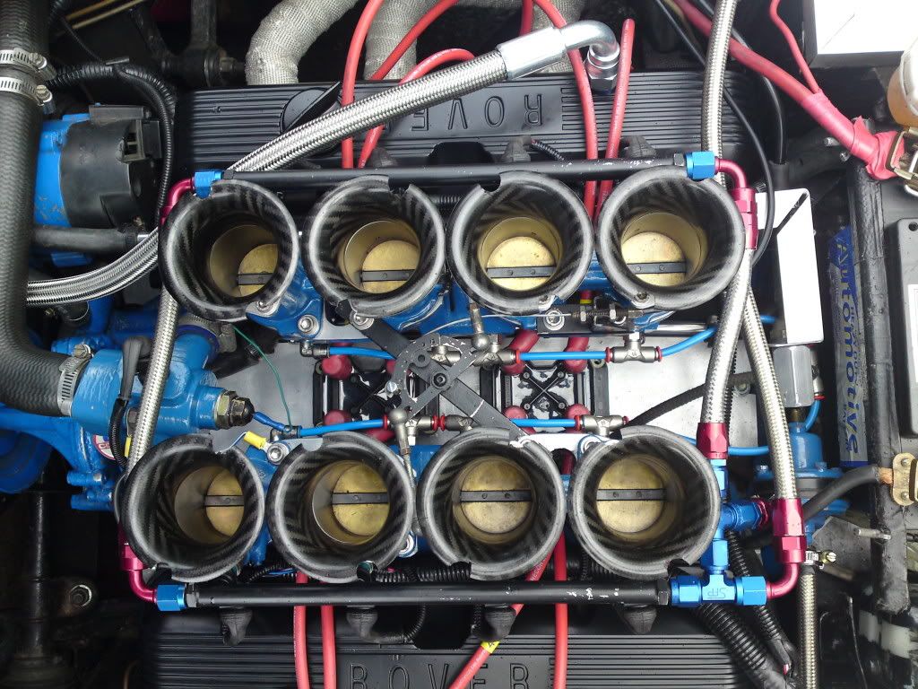

Finally got round to taking some pictures of my new induction set-up: -
Image[/img]

Are they mounted on weber manifolds? They look like webers without the guts too! So any plans to put some filters on the tops or is the engine going to be like a big leaf sucker?!!!!

I WANT THOSE RAM PIPES!!!!! :D :D :D
Those manifolds look like TVR Racecar/JE ones to me, very similar to the ones I use,
I did away with the vacuum lines as mine were only goint to my fuel reg and as its not a rising rate system, they got deleted,
how did you get your coilpacks in there, it took a week of faffing about to get mine to fit, and they are still VERY tight in position,

topcatproduction wrote:Are they mounted on weber manifolds? They look like webers without the guts too! So any plans to put some filters on the tops or is the engine going to be like a big leaf sucker?!!!!
TC
They're mounted on JE manifolds, going to fit some filters but I need to modify my bonnet first to fit them in :oops:

ian.stewart wrote:I WANT THOSE RAM PIPES!!!!! :D :D :D
The coilpacks took ages to do because I fitted the manifolds first before I realised I could fit the coilpacks in there, then I found out that the vacuum lines were approx 2mm too low so ended up cutting the coilpacks and the plug leads down :shock:
