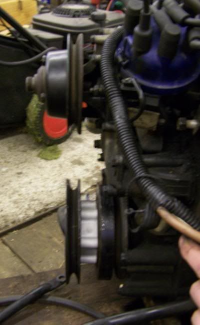

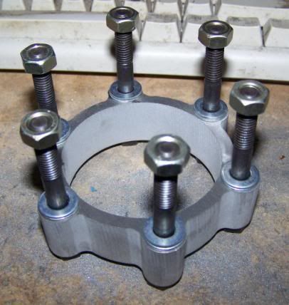

reducing pulleys/smaller water pump
well i have used the top inner pulley, removed the outer bottom one and spaced the inner bottom one out to line up with the top one, saving 25mm ish, makes it 25mm less likely i will have to modify drive shafts.
if i still have trouble i will have to modify the top pulley to bring it further in to the engine.
