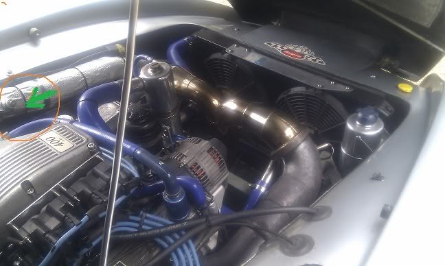

P.S what have you wrapped your intake pipe in? and where did you get it mate?

Hi Coops, cant help with the Ign map at the moment as i dont have the laptop with me (daughter uses it) but the intake wrap i purchased from Ebay some years back similar to this stuff http://www.ebay.co.uk/itm/Heat-Shield-A ... 3360c03a43 :D

looks like the car is drawing too much heat from the engine,Radiator exhaust etc,
had the filter and IAT hanging out the front of the engine bay on a flexible hose and the IAT sat around 19C at idle, and when hot started was at 24C but dropped back down ton 19C within 40secs, (would of been around 70-80C if in engine bay)
so new filter and enclosed housing waiting to be ordered that has a cold feed pipe to go to the front grill, fingers crossed this eliminates any engine bay heat getting into the system,
also moving the IAT from above the N/S exhaust mani helped a bit too,
next thing, where should i mount it now? as on my nissan the IAT is in the pipe GOING to the air filter not from filter to engine,

our make shift setup to see if she hot starts any better and she did,
and yup the IAT sensor was placed inside the filter :lol:
