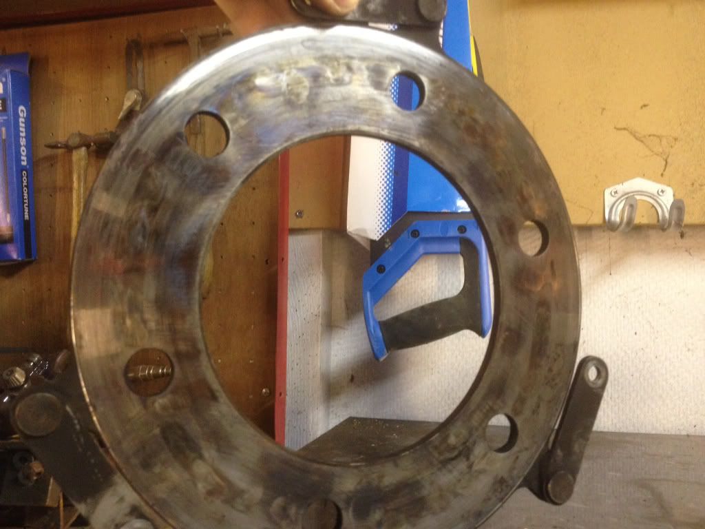

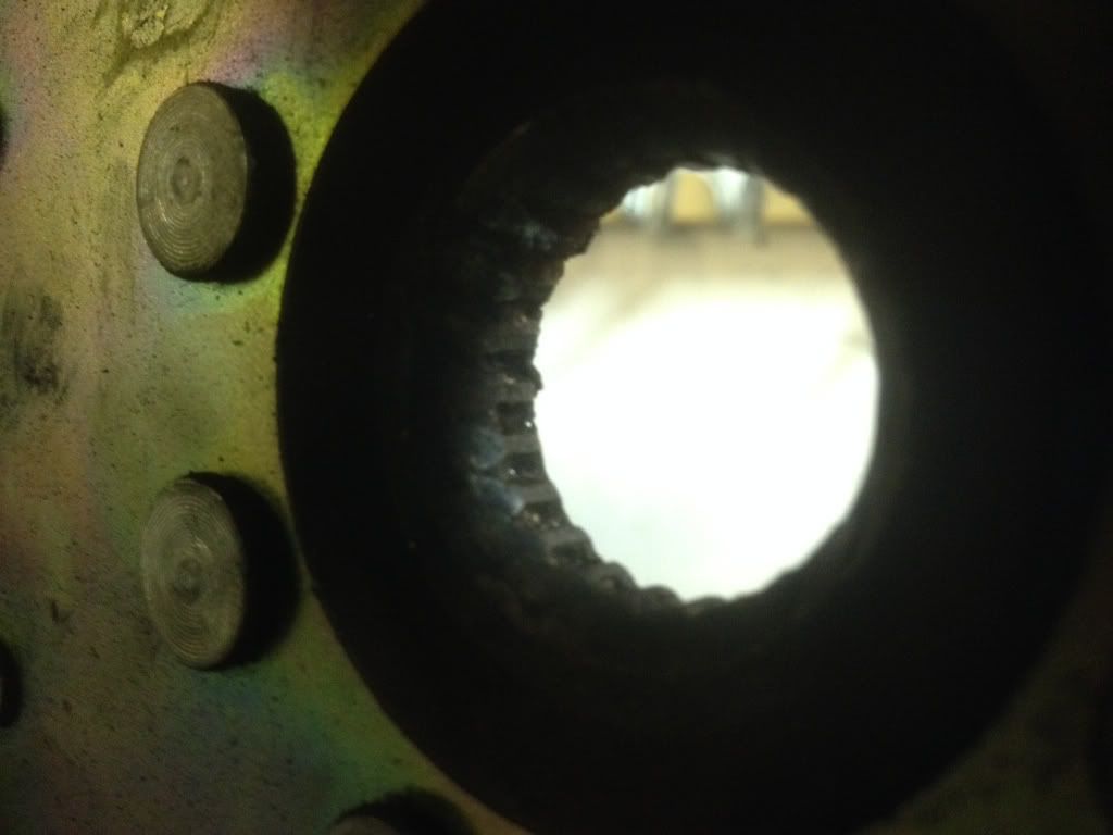

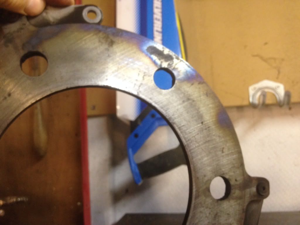

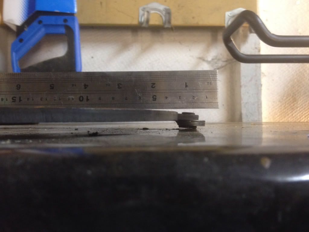

I've just got round to spending some time on the car, the clutch is goosed but I can't see how this could happen?
Image[/img]
The last photo shows the inner flywheel badly warped.
