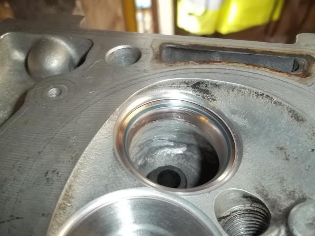

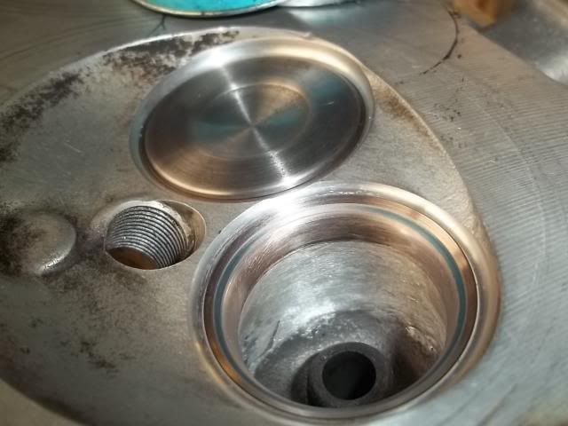

This probably relates to half a dozen other threads but will put it here for now
OK
A lapped in seat that produced a nice grey line all the way around which has now been blued where you can see a low spot - bear in mind that the blue is only microns thick.
Other side of seat also the blue is thinning indicating another low.
And after further checking and lapping in to get a perfect seal all around and uniform seat thickness - It will start at around 1mm but after a few miles will increase in width and seal
Having a perfect seal means no loss of pressure no hot spots etc etc. And it does not take that much extra effort.
