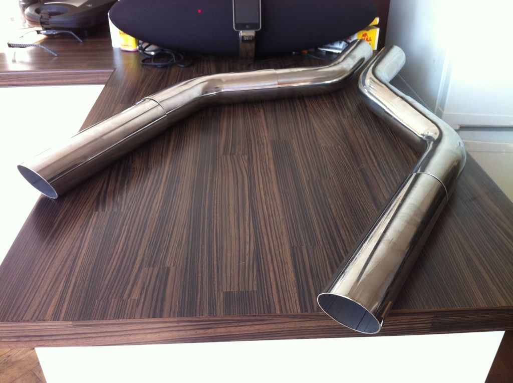

The old tailpipes on my TVR Chimaera have had a hard life and got to this state
So i bought a few pieces of tube off fleabay. The rear sections are a slightly bigger bore and allow the 45 degree bends to slide over each other and allow for adjustment and alignment on the car before committing to welding
I am pleased with the result. They fit better and sound great at a fraction of the price of a system from the specialists. :D

Nice bit of work there! :)
Nice
