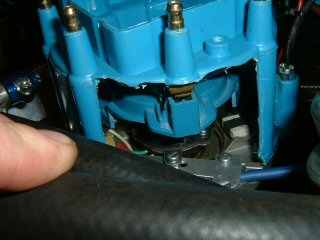

An alternative to the coathanger method is to simply cut a hole in a old cap to see the aliginment of your rotor and cap:
