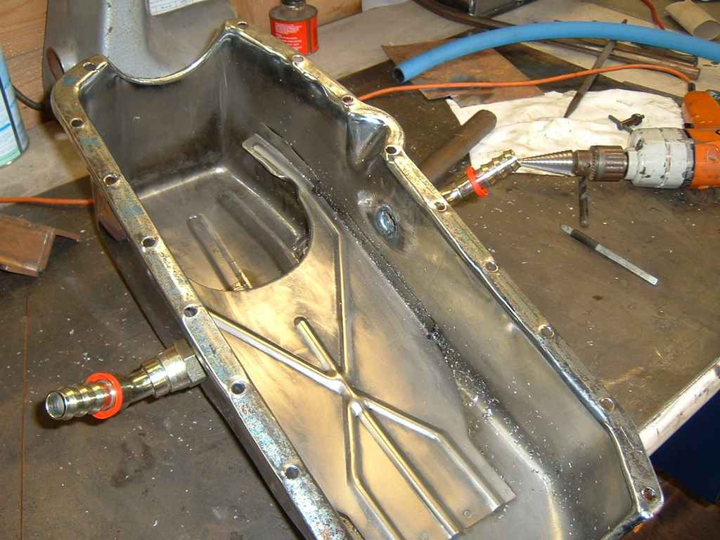

I used two weld-on -10 fittings - welded from the inside to look neat:
http://www.mez.co.uk/dcam/DSCF0589.JPG

Welding is ideal, but obviously you need the ability to weld.
bulkhead is just a drill job.. A Normal male-male fitting with a nut on the back would likely work too, but a bulkhead is safe as far as length of thread available goes.. Just cut off any excess.
Use a dowty seal to seal one side, or both.
Thanks all. I did indeed mean something like a bulkhead connector... if I use a weld-on fitting it will fall off, guaranteed
Was hoping to find something that kept the lock nut on the outside just to minimise the potential for bits dropping in the sump in event of failure... will have a gander at the links etc
