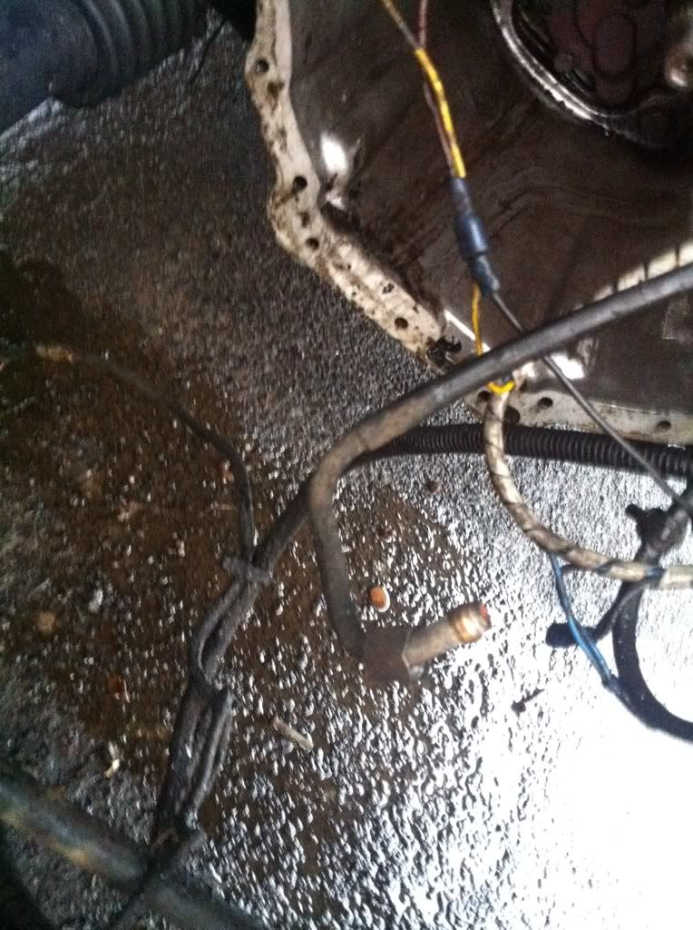

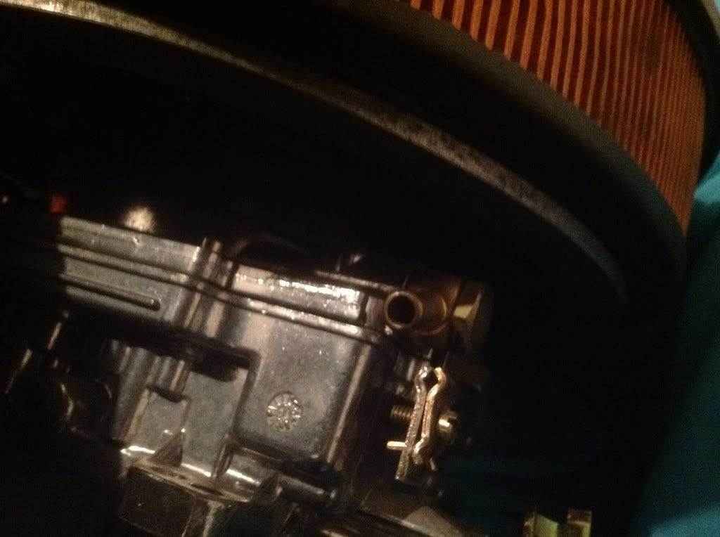

Here's a pic of the existing line and the carb connection too...

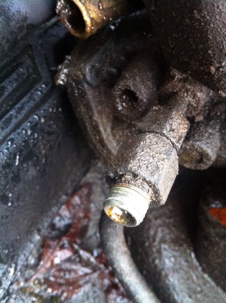

And this is what I need to get to
Just wondered how other people did it, im a little stuck as the original fuel line is hard plastic.
Cheers mike
If you dont want to run a new line I would think about gently cutting through the olive with a juniour hacksaw. Just cut it deep enough to leave a fraction of brass left. Insert a screwdriver into the slot you have just made and twist. It should snap off so you can then slide the nut off and have a section of metal pipe left to fit hose and clips :)
You may be lucky and find that it will twist off if you try very gently with some pliars or push the nut over the olive and use an adjustable spanner to tap the nut.
You get the idea eh?
Olive off without damaging pipe. Fuel hose and clips to join pipe and carb :)
