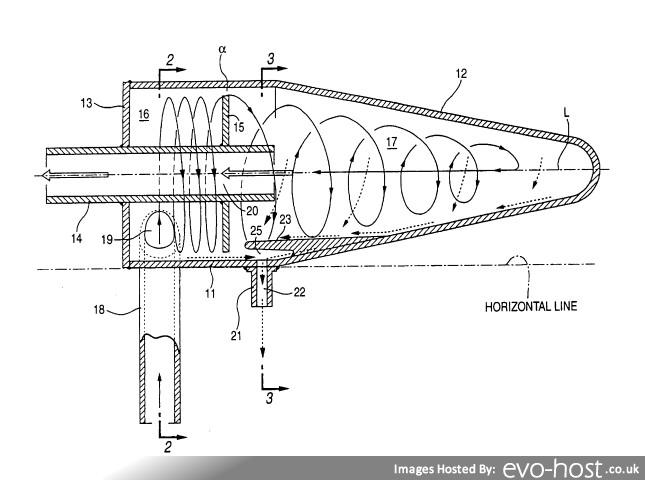

Or here is an image of a schematic of an OEM M5 separator, which has some well thought out design.
OOPs, turned out bigger than expected lol
http://www.evo-host.co.uk/getimg/30068.jpg
