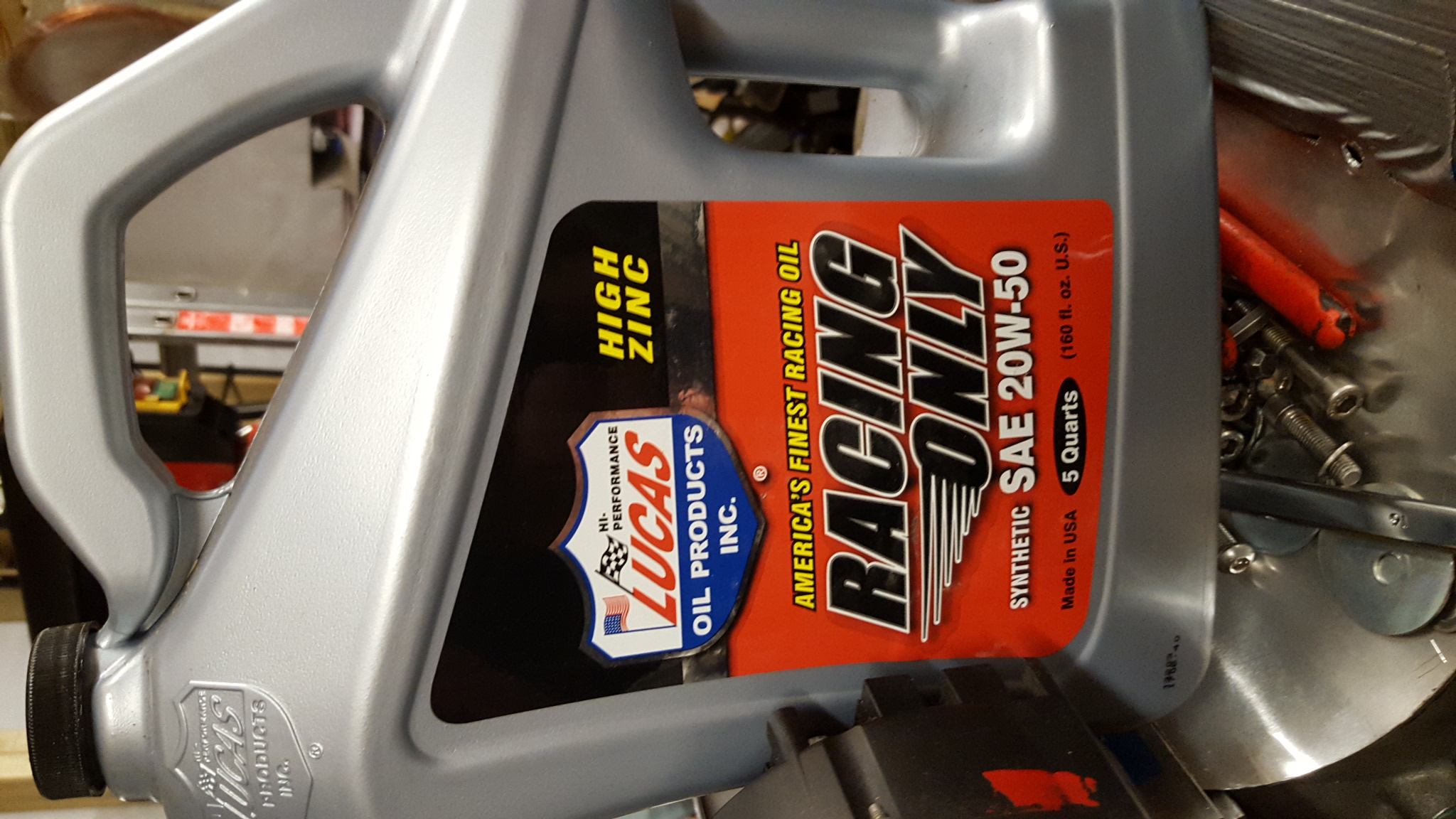

Re: Engine Oils. which ones???
What I use and have done for many years even. In my current engine
