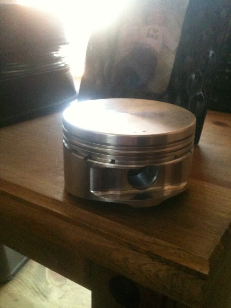

Im back thanks for all your help so far. My pistons turned up the other day they are the Ford Modular Manley 3.700" Forged Flat Tops
It says the compression height is 1.220 on the box
Is there a way of working out what rods I should use on my 4.6 engine? Either the 4.0 or 4.6 ones?
I will be using the Buick 300 heads. Looking for 8.5.1 compression I think but open to suggestions / advice...
Many Thanks
Neal
Image[/url]
At this point it would be a good idea to measure accuratly the chamber volume of your heads. Also has the block been machined yet? if it has then get an accurate measurment of the deck height, if not machined yet then it gives us another variable to play with. . .
I presume you are not reboring as you have bought standard bore heads so are you having the decks trued up?
In an ideal world the distance between the flat face of the head and the top of the piston (squish distance) would be between 35 and 45 thou of an inch, this is piston distance down the bore plus gasket thichness, you have 2 gaskets to choose from, tin and composite, tins are 18thou and composites are 48 thou.
If I assume you are going for composites then you want to have the pistons ending up at + 3 thou out the block minimum.
standard deck height un machined is 8.96", your piston height is 1.22" and your stroke is 3.2".
So rod length= 8.96 -(half stroke, 1.6 + piston height, 1.22) = 6.14" plus 3 thou = 6.143"
Now to look at the compression ratio CR = 1+(swept volume of 1 piston/volume above piston) = 1 + 575/(58cc (aprox chamber volume) + 8) =9.72
So you are looking for some rods of about 6.14 to 6.15 length (aftermarket chevy ones?) and a CR in the region of 9.7 to 9.9 to 1 or less swept volume and longer rods but a lower CR
As I said in the last post on this I would have looked for the ones with a dish in them if you wanted the 8.5:1 cr and 4.6 litres, or go for a 4 litre crank and I'll recalculate the rod length.

I dont think 6mm out the pistsons is going to work they would seriously weaken them alot I think.

I have the pistons in front of me now I reckon the crowns are 6mm thick according to my steel ruler.
