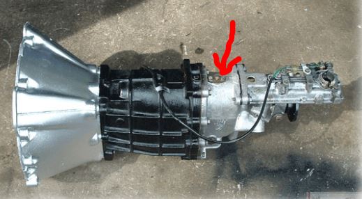

Gear box identification
the identification marks can be found on an oval lug near the base of the box
G16A SD1 2000 (Could be 4 speed)
G17A SD1 2300/2600 5 speed
G19A SD1 3500 SE/VP 5 speed
G22A SD1 3500 Police spec 5 speed
G23A SD1 2600 Police spec 5 speed
G26A SD1 2400 Diesel 5 speed
G27A SD1 2000 Later model 5 speed
G28A SD1 Vitesse 5 speed
G30A Sherpa Range

Sorry about posting this in a nice tidy topic but i have what i suspect is an LT77 box, It looks the same as an LT77 i am fitting to my Manta but when i went to try and ID this box from the oval flat area by the drain plug i found that not only was the number not there but the machined area was missing too, it was just a plain casting from the factory, i can find no other numbers anywhere.
Any idea what i have here ?

Numbers stamped on the bottom of mine near where it joins the back nose casting, looking at the list it suggests its an SD1 police type. Nice !

i have a lt77 ( G17A ) i read on here is from sd1 23/26 5spd
but i cannot get 5th gear, could it be a 4spd box ? or i got other problem :roll:
richyb66
Posts: 34
Re: LT77 Gearbox Identification
Post by richyb66 »
It's more likely to be a problem that missing completely. G17A would indicate 5 speed but I wouldn't put it past BL to have got the wrong number on it. If you can see it look at the small oval plate on top of the box closest to the gear lever (retained by 2 bolts that are aligned along the length of the gearbox).
If the oval plate is a plain flat plate, then the box is 4 speed. If it has a round pin in the centre of it, it's the locating pin for the 5th gear spool in which case the problem is either knackered rubber bushes on the remote gearchange extension, or something else internal.
