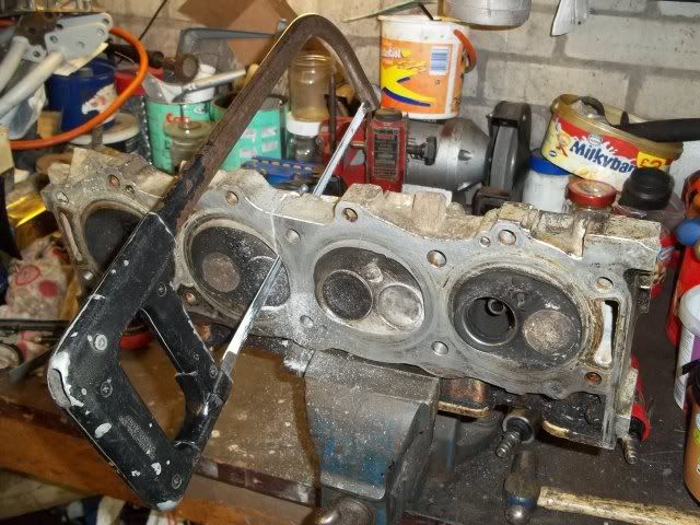

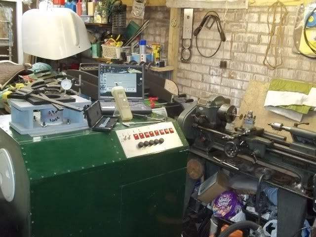

Something to test - at a reasonable size - it's a later head but not with waisted stems and one of the odd ones with the exhaust gas port things I wish I had a band saw.
A couple of bits of scrap to work with.
Look at the amount of carbon in here
The one we will start with first

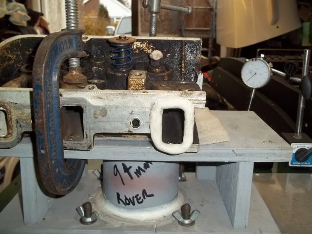

An open flow test with nothing in the port just to get a datum

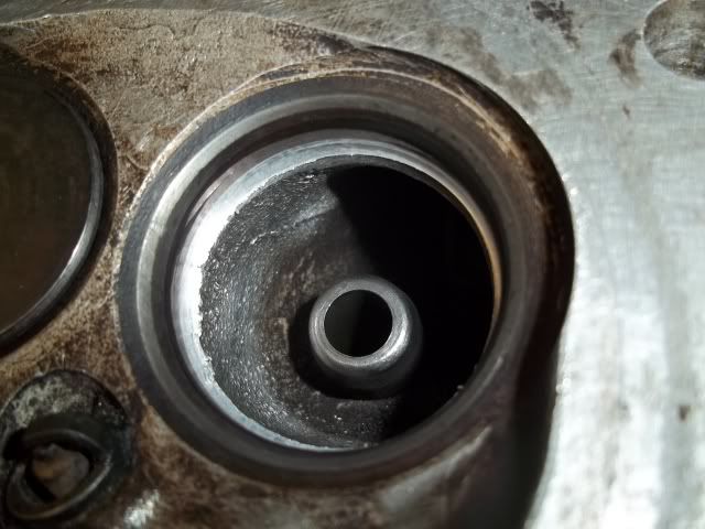

The first parts in the port that need to be removed - no changes to the seat internal diameter at this stage
Thats got it started - see if i can get it progressed during the this week
A I have a base run with the standard head and valve
B run with the waisted valve with a cut back
C run with the waisted valve and a basic port blend std seat id at 34.7mm
D run with the waisted valve and the insert taken to 36mm and blended
Just need to combine the graphs.
But here are the flows at 450" - @ 28"
Open - 141.5
A= 134.5 cfm
B= 137.0 cfm
C= 138.9 cfm
D= 137.1 cfm
None of the porting work at present extends further than 3/4" into the port
