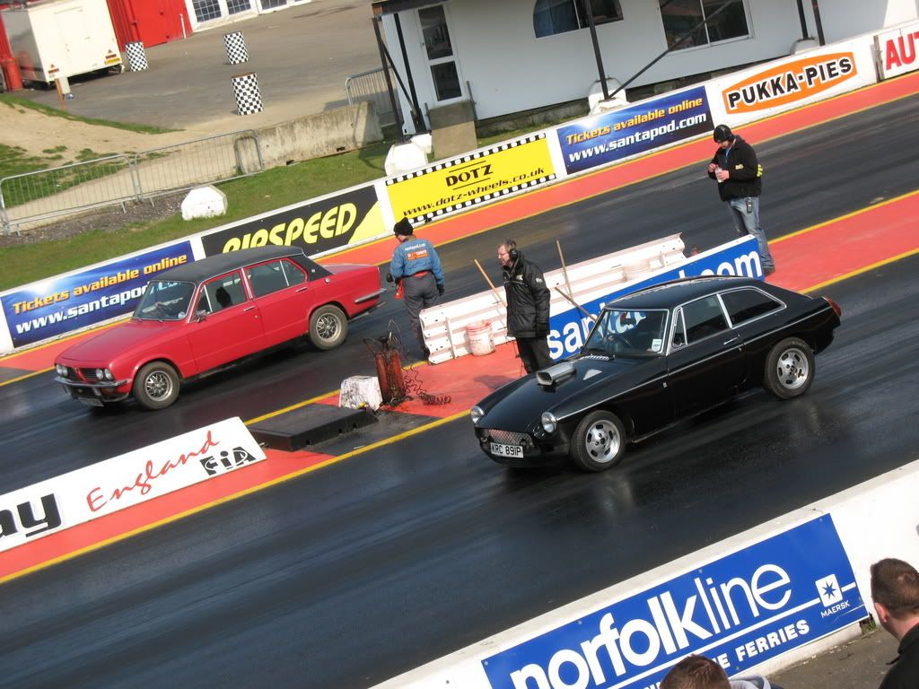

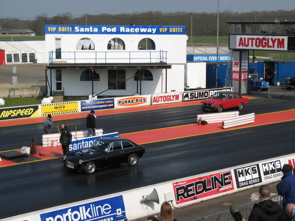

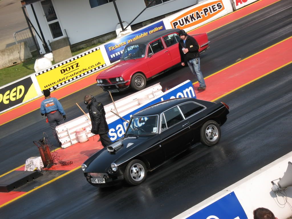

I met a couple of guys with their V8 Triumph today. Thanks for taking the vids and pics of me trying to start the MGB V8. It was the dissy drive cog that failed. Thats why it was backfiring through the carb and then the exhaust. The timing was slipping a couple of teeth every revolution.
I've already got it stripped and ready for a new cog in a couple of days.
Email me the vids and pics when you get a mo please.
