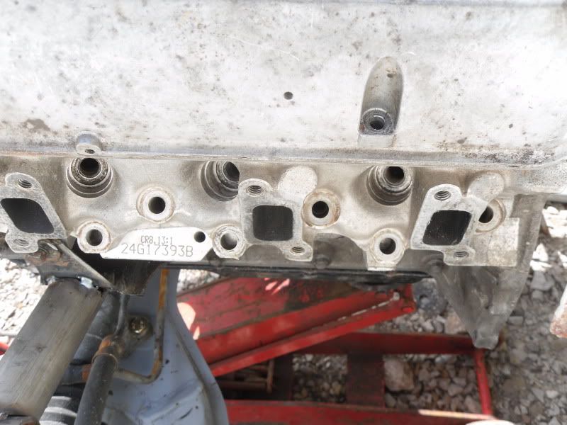

I recently bought an engine, it had roller rockers, and I was pleasantly surprised that the heads had been very nicely ported, so I am going to utilise them, however, when I placed the heads on my block for the first time yesterday, I noticed that the heads have an extra set of bolt holes, and the block is devoid of tappings to take said bolts. The block is a 3.5 item, that is x-bolted (the reason I bought it in the first place), but only has 8 boltholes per head.
Question is, will I still be able to use the heads, and would it be worth drilling and inserting the block to utilise the extra fastenings?
Opinions please.......................Thanks.

No you don't need the outer bolts which are missing on you're block. Your heads maybe the older type which includes the extra row of bolts and also a larger combustion chamber, 36cc. The later heads have a 28cc chamber.
May be worth measuring your combustion chamber to confirm?

Definitely DO NOT use the outer row of bolts. The extra row cause the head to tilt over slightly, relieving pressure on the valley side of the head, and causing leakage into the valley area. This is the reason that all old Rover V8's are sludged up, it's combustion products getting into the valley and into the oil. When the P38 Range Rover was introduced, they went to composite gaskets, and a symmetrical clamping regime to eliminate this problem. You won't find a sludgy P38 engine.
Most engine builders just omit the outer row of bolts if the holes are present.

ChrisJC wrote:Definitely DO NOT use the outer row of bolts. The extra row cause the head to tilt over slightly, relieving pressure on the valley side of the head, and causing leakage into the valley area. This is the reason that all old Rover V8's are sludged up, it's combustion products getting into the valley and into the oil. When the P38 Range Rover was introduced, they went to composite gaskets, and a symmetrical clamping regime to eliminate this problem. You won't find a sludgy P38 engine.
Interesting theory - but if there were combustion gasses leaking into the valley, wouldn't the head gaskets blow in short order?
IMHO, old engines are sludged up because the breathers and other servicing has been lax. Although no engine stays clean inside forever.

DaveEFI wrote: Interesting theory - but if there were combustion gasses leaking into the valley, wouldn't the head gaskets blow in short order?
No. If you take the tin gaskets off a well used 14-bolt engine, you will see that they are stained on the valley side, and clean on the outer side. I've seen it many times on knackered old engines. If you change your oil regularly, it's not a problem, but as soon as you start stretching service intervals, the oil gets sludgy and deposits it everywhere.
It's a marginal leak, but over time it is significant.
