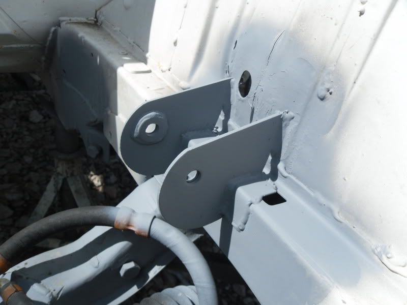

Well, I did it, had a good day yesterday, positioned the engine and fabbed some mountings up, got the engine nicely back and down too...........
In position.........

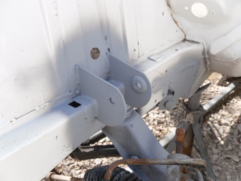

Tack on chassis brackets..........

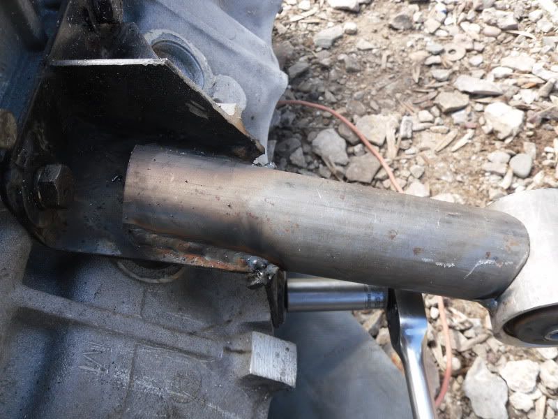

Tack tubes to bush mounts, I have used the V8 mounts but modified them and cut them down...............
Fitted the heads and covers to check clearances..........
Then take em off and weld them properly.............
All done..............
Then finish the chassis side of the job..........done!

The concerns I would have there are how leverage is now acting on the mounts, and weight is hanging from them.
IMO it looks there will be more loads chucked through the tiny upper mount ( single bolt ), than the lower fixings on the block body.
- Posts: 4075
It's not even the tube I'm talking about. I'd say it's strong enough as does look fairly substantial.
More about how it interacts with the block fixings. It just looks wrong as all the loads will be distributed to the wrong places.
Although the actual rubber bits look good, what are they off ?
