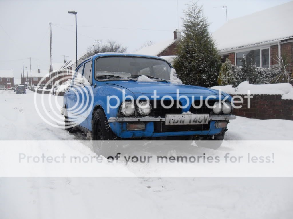

ive had this car since 2008 and ran it for a year completey bog standard
this didnt stay that way for long as it was terribly unreliable ,if it wasnt headgaskets,,it was the standard 10 derived running gear dying
so with all that in the bin i swapped to a RV8,LDV 200 lt77s and shortened prop,,and a sprint salisbury axle over a few months
Image as bought,,bog stock 1500hl,,no rot,,but terrible running gear
2.5 years later,,,
