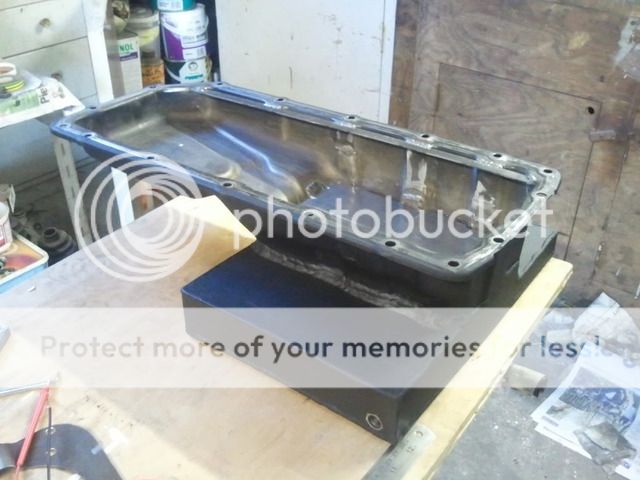

To be honest I've never been very happy with the pickup that came with my trapdoor sump (which appears to be identical to this one). The inside of the pipe is slightly obstructed by blobs of weld, and the end of the pipe pushes right up against the gauze meaning there is a much smaller area where oil can be drawn.
For these reasons, when I originally fitted this sump I decided to modify a standard pickup (small type) rather than using the one that came with it. Lots of measuring of clearance was done then too. But I later dumped this when trying to figure out my bogus oil flow issue, as I figured my cut n' shut pickup was more likely to be leaking air or causing another problem than the TIG welded & supposedly accurately made one that came with the sump . Ironically, after lots of careful thought around this, I ended up with the only sump/pickup combination that I hadn't measured properly!
Anyone know who manufactures these stainless trapdoor sumps, or if many other people run them? Would be interested to know how well the design works to control oil starvation etc in practice.
I'll be keeping a very close watch of my oil gauge on first start up, checking for dropping pressure with rising revs, very usefull thread.
I looked into buying a trap door sump and I must admit I struggled to see the justification behind them. In my mind it would be much more benificial to have some one way valves/umbrella valves in the horizontal baffle plate letting oil into the sump bowl but not letting it climb out. I did some testing on my own sump, just filled my sump with oil after modifiying it (I made it shallower and winged) and sloshed it arround to see what happened. One thing I noted was the vertical trap doors I moched up needed to be a very good fit otherwise the oil will just flow past them. In the end I just used a horizontal baffle plate like the standard rover v8 but made it fit better around the edges so the oil couldn't climb out so easily. I also looked at using a scrapper finger plate but I measured it and could only fit one for less than 1/3 of the crank so I fitted a thin straight scrapper to the one edge which they do in the JE baffled sump.
In my mind it would be very usefull to be able to see the engine running with a clear sump so you could adjust the oil level so it's as deep/high as possible without touching the crank.
