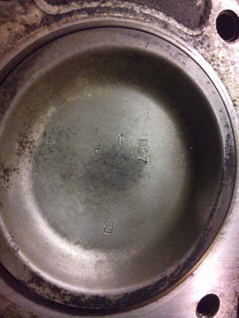

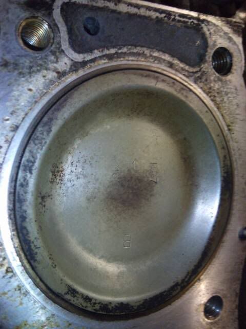

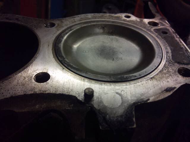

I've had a chance to have another look at the engine, I've taken the heads and sump off, all looks nice and clean so far no nasty surprises so far!
I've done a bit of a check and the heads measure up at 35cc's they have been punch stamped 35cc on the front ends as well!
The pistons seem deeper than the ones on the engine in the car, the trouble is the heads are back on in the car so I cannot compare them! I did a bit of a check and the dish in them seems to measure up at 34 to 35 cc's I've taken a couple of pics hopefully I can post them on here.
The piston at tdc seems to stick slightly proud of the block, again as the other heads are back together on the engine in the car I can't compare them.
So any one shed any light on what the pistons are? will they give me enough compression?

Ohh and forgot to ask any ideas on the pistons?
I'm thinking perhaps the best option with the heads/pistons will perhaps be wait till I have the proper late 4.6 heads off when I'm taking the engine back out so I can compare everything then make the decision, only thing is I was hoping to built as much as possible before stripping the car and making it a 2 ton lump that I can't move around!
