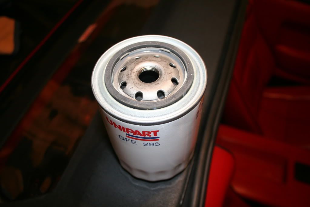

Went to local Unipart and asked for GFE181 - been superseded by GFE295
Change went OK - oil pressure sat at start where it was before and then as the engine warmed the needle started to fall. It got to 0.5 and I switched off. Checked the filter for leaks and started again revved to 2000 and it would not hold pressure properly - it was all over the place.

I don't know why but I decided to order a Fram and tried that: Oil pressure 50% higher at ide and no falling back when warm or variability
As you can see there on the Fram there's an angled shoulder leading to the rubber ring, there are eight larger holes and a much more pronounced plateau leading to the centre hole
Also there is a spring mechanism about an inch inside the central hole of the Unipart not present on the Fram
