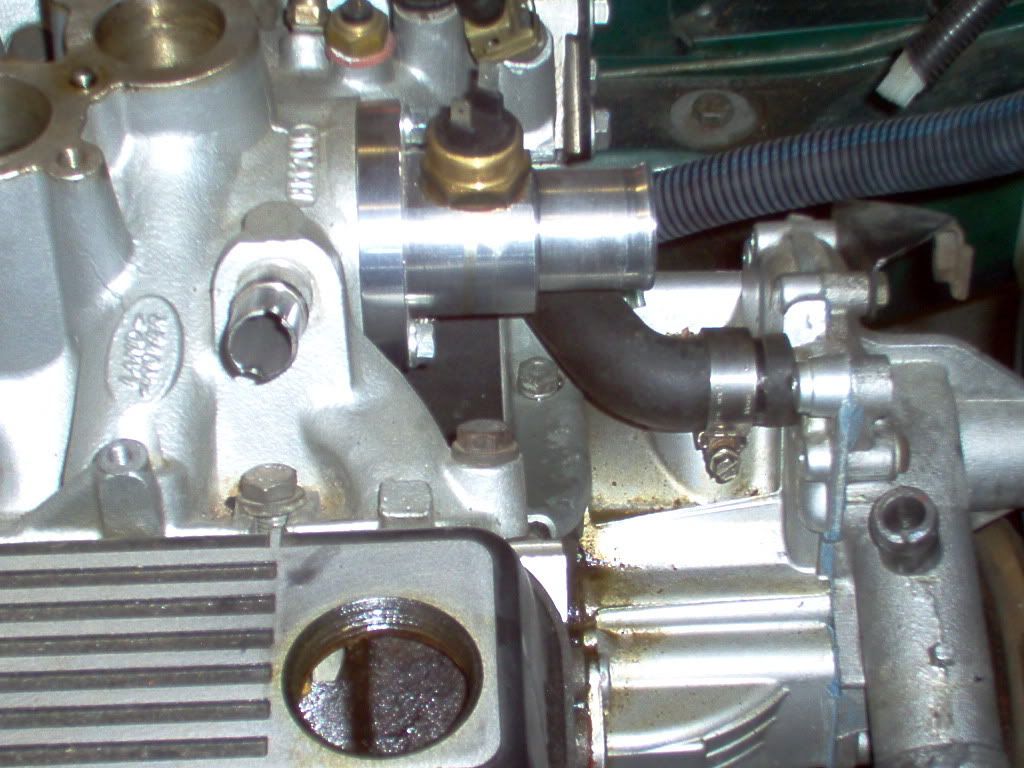

Decided to machine my own thermostat housing which goes straight out. This is for my TR8, which has the serp front cover, Mallory dist, and one-off radiator. The Range Rover and TR8 thermostat housings go off in some direction. With my straight design the top hose clears my distributor and alternator. I also incorporated a temp sensor for the elec fan because the TR8 had the sensor on the radiator. This housing has an extra mounting hole which will allow me to also bolt it to a Bosch type lower intake manifold. In the future I plan to experiment with the Bosch lower manifold with a custom upper manifold.
