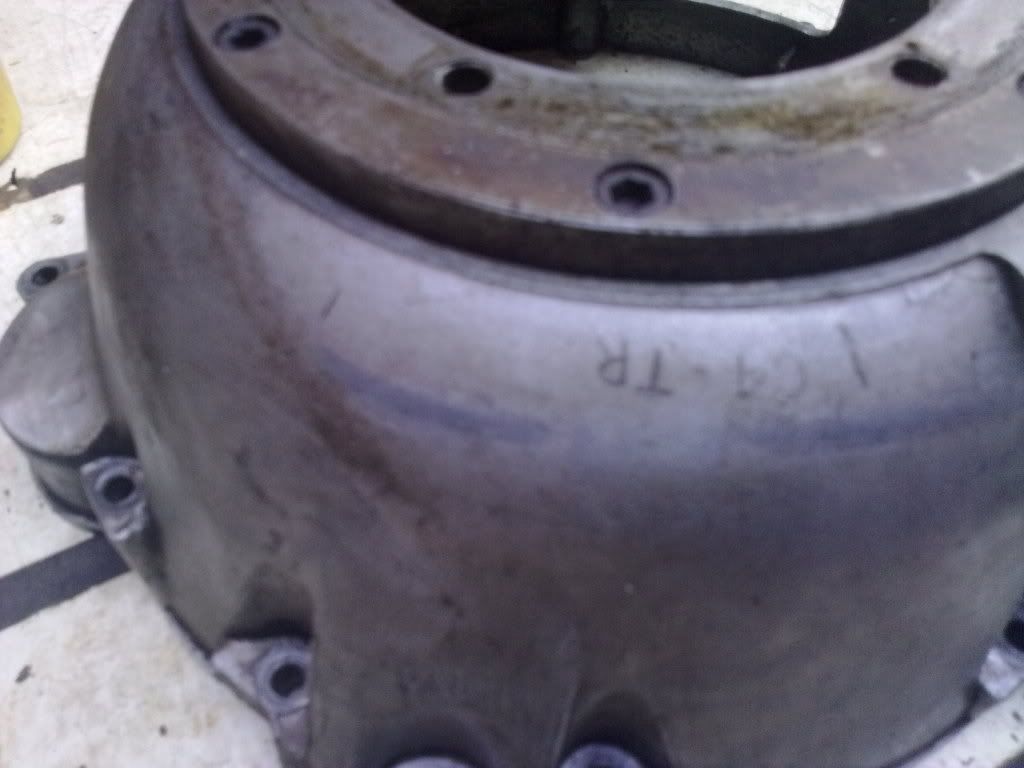

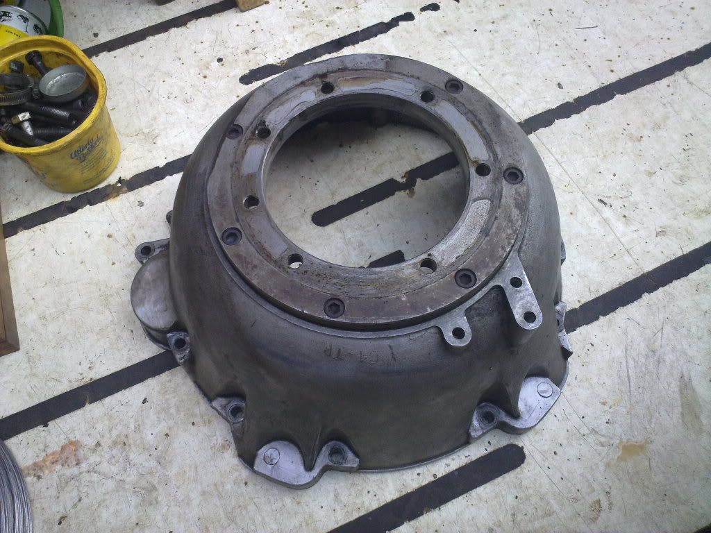

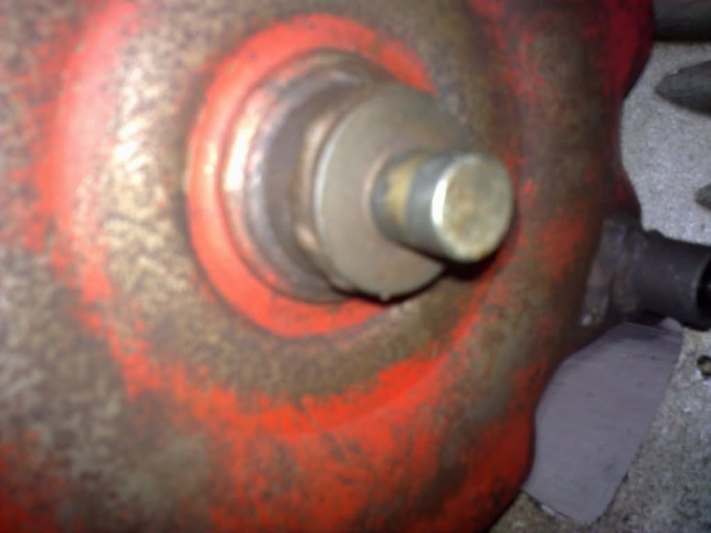

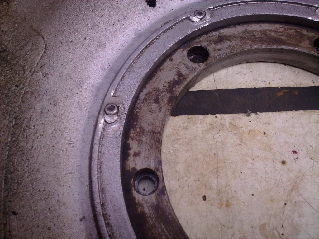

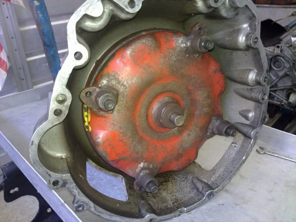

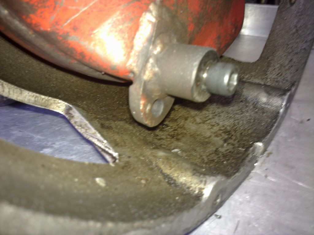

Finally got a chance to take some pictures of the bellhousing conversion.
Gearbox is a case fill C4 that the bellhousing bolts on to the pump. Bell housing is a Borg Warner 35 from an older Rover Auto.
Any one want to know more just ask. The steel ring and the spacers are all 1" thick, diameters on the ring are to fit snugly and locate centrally on the two castings.
