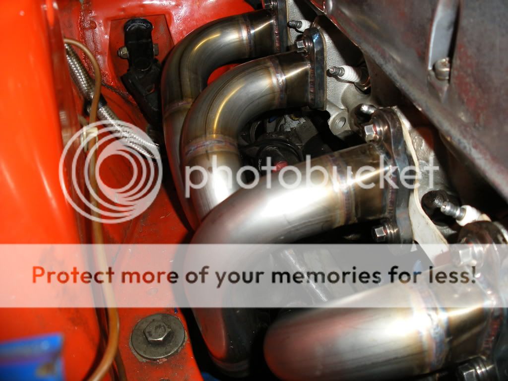

Trickys new exhaust system :lol:
My new system is being built at Wolfy's workshop near Brackley Northants
and i must say his workmanship superb
The primarys are 1" 3/4 going from 4 to 2 to 1 he has manage to get 11" longer primarys in going into 2" secondaries and then into a 3" single system :D :D

Nice.

Love the way the square flange turns into the circular tubing, good welding skills as well.

On the exhaust is it mild or stainless I hope mild or the heat transfer into your engine bay will be increased

They do look good, should work better with your combo than the old headers. Bet your looking forward to running the new set-up down the strip!
