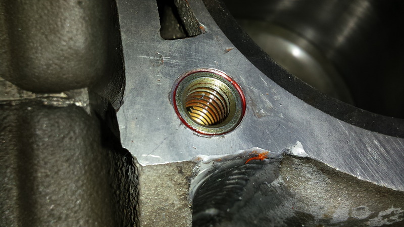

Dont use helicoils as they will pull out. For about a third of the price of buying kits to make the repair just google a Mobile Thread Repair Service near you and they will come and do it for you - always a top class job.
Here is mine.
Garry
