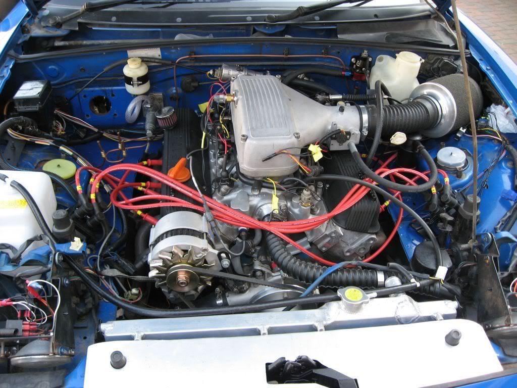

Pictures please!topcatproduction wrote:...its a SC 4l RV8 (maybe with a little nos shot) in a little mx5...
I'll start...
I have also been thinking about getting a lighter flywheel in the future but sometimes think I'd be better off saving my money for an LSx engine instead.
